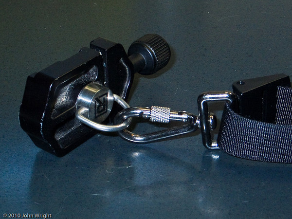

That's certainly one way to adapt the BR strap to an Arca Swiss plate.
What I did was attach the Black Rapid FastnR to an Arca Swiss clamp I bought from Kirk Photo. If I need to put the camera on the tripod, I just remove the clamp from the camera plate and I'm good to go.

How is it better than just unscrewing FastenR-3 from Arca Swiss plate?

You don't unscrew anything with that setup. The AS clamp stays on the strap and he just unclips the camera from that clamp and mounts it to his tripod.

I know we are splitting hairs here,but you still have to unscrew the clamp itself as well as having the bulk of an extra clamp.The other way you just slap it on the tripod as is;)

Really, the only difference is the added mass of the clamp; either way one has to unscrew SOMETHING to get the camera off the strap and onto the tripod. I like your solution better as it's more compact; but the release knobs on those AS clamps is much faster to loosen/tighten than the BR clip is.

Like the OP mentioned my concern would be the long term strength of the Adapt-its adapter. I don't really want to place the fate of my camera and 70-200 2.8 MII on that rubber loop. I have a similar clamp that JWright posted but its from ReallyRightStuff.

The FastenR has been known to unscrew itself if not properly installed (with moisture on the rubber washer) and drop the camera. :cry:
When attached to a AS Clamp, you can Loctite the FastenR in place and not have to worry. :D
Plus, opening the clamp is much quicker than fiddling around with mounting/unmounting the FastenR from the camera each time you use a tripod. ;)

Quicker...

Perzactly... My FastenR is Loctited to the clamp, therefore I have to remove the clamp/strap combination from the camera before placing it on the tripod.
