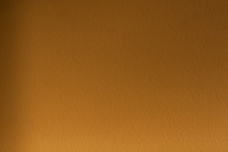

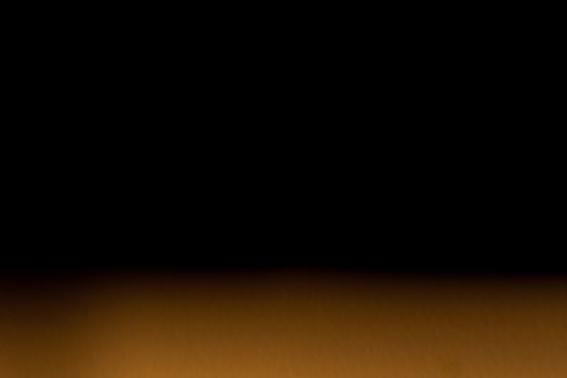

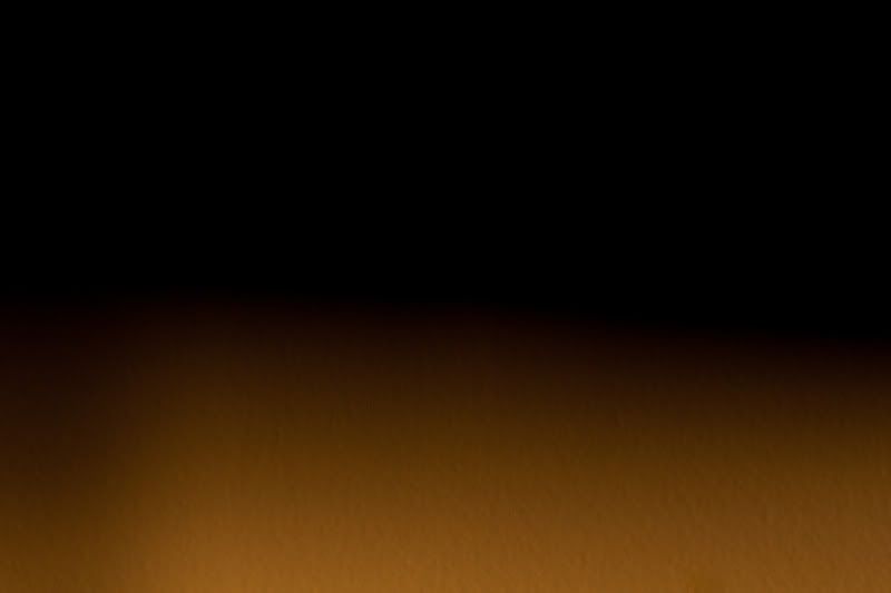

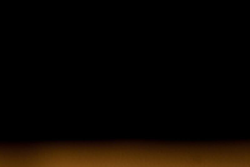

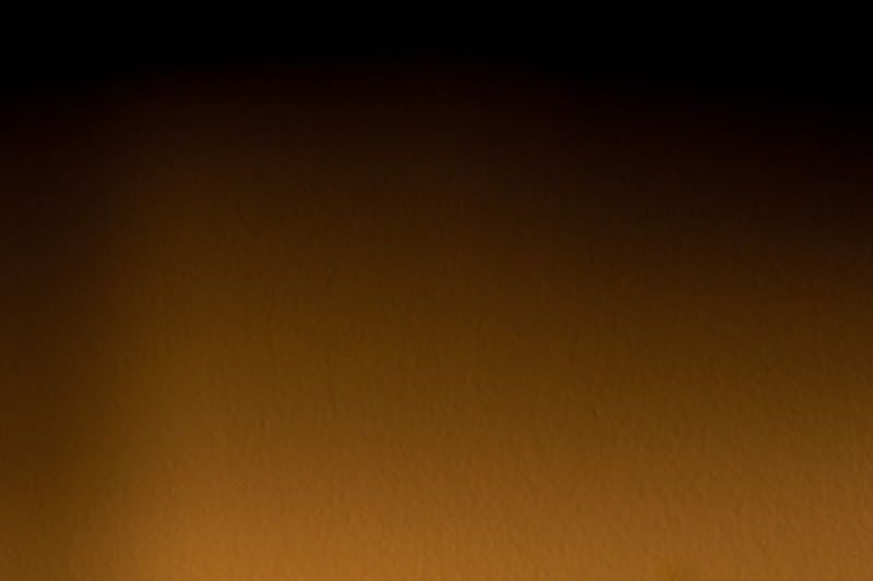

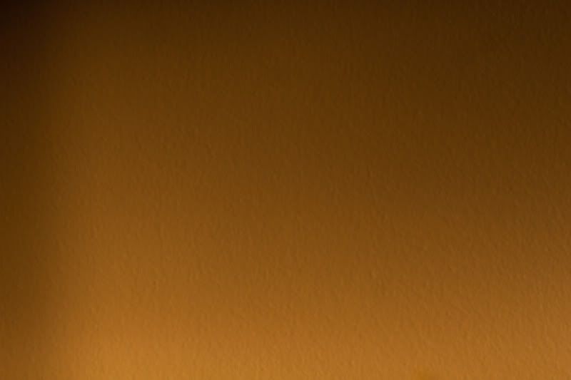

Hey guys. Recently I've noticed that my 20D cant capture the full photo at higher shutter speeds. I've read a few things about people with similar problems, but they all seem to not be shutter speed dependent. Mine is completely shutter speed dependent.
Heres a few examples to show what i mean. If anyone can help, I'd really appreciate it. The camera still works great in every other way, so I'm hoping its not too major. But it does seem to be getting worse.
Thanks for any help
1/2500th

1/3200th
IMAGE: http://i76.photobucket.com/albums/j15/burd43/IMG_6977.jpg
1/4000th
IMAGE: http://i76.photobucket.com/albums/j15/burd43/IMG_6978.jpg
1/5000th
IMAGE: http://i76.photobucket.com/albums/j15/burd43/IMG_6979.jpg
1/6400th
IMAGE: http://i76.photobucket.com/albums/j15/burd43/IMG_6980.jpg
1/8000th
IMAGE: http://i76.photobucket.com/albums/j15/burd43/IMG_6981.jpg

If this happens with different lenses then it looks like some type of shutter assembly issue. Not even sure if Canon services the 20D or not? There are several places that I have seen listed that service older equipment so maybe you can find that info somewhere..... Sorry.

Front focusing issues might be fixable with a simple cleaning and adjustment.... Might not be all that expensive, if that's all that's needed. Since it's an older camera and out of warranty, look for a local camera repair tech who will take a look at it and give you an estimate. That will probably be cheaper than sending it to Canon for that type of service. (It is possible that an AF componenent is failing, though.)
Shutter issue more likely will need replacement of the entire module, which is more involved, requiring more labor, and there is the cost of parts, too.
However, the image examples above are not typical of a failing shutter.... They look more like a slow/sluggish shutter, rather than a broken one. It might be possible to have it cleaned an lubricated by a local tech (Canon service wouldn't do that, they'd just replace it). I haven't tried cleaning and lubricating a modern Canon shutter personally, so really don't know what's involved or what's possible. Take it to a local tech and talk with them about it.
