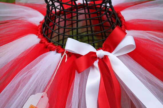

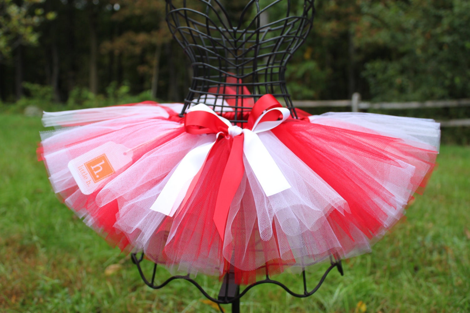

My wife has a business making tutus and is looking to start taking some better photos of her products. Until now, she has been taking her photos with my camera outside because it was the best she could do. Given that we have to deal with a long and cold winter here in New England, she's looking to start taking them indoors. She also wants them to be a bit more professional looking (than having grass and trees in the background). I know very little about lighting, and am trying to find a basic, inexpensive lighting kit that we can use.
I have been looking at some fluorescent continuous 2-light kits with softboxes (such as this: http://www.adorama.com​/FPSSBK2.html (external link)), as the continuous lighting seems like it'd be a bit easier to work with than strobes. Here's some examples of the photos she currently has:
IMAGE: http://img0.etsystatic.com/il_570xN.290354196.jpg
IMAGE: http://img2.etsystatic.com/il_570xN.290354218.jpg
She's basically trying to get photos that are a bit more professional-looking and well lit. Do you think a basic kit like that could do that?
