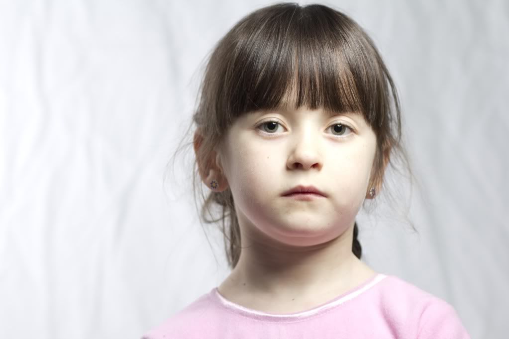

Dec 27, 2011 15:46 |  #4
Here is a shot straight from camera - excuse the pose - my daughter wasnt happy :)
I selected the focus point as her left eye (our right) and it seems as though the nose is more in focus?!
It does this quite often - initially I thought it was my technique, then the lens, now the camera!
What do I do?!
thanks again

thedcmule2
1,125 posts
Joined Nov 2011
Dec 27, 2011 15:51 |  #6
Looks like it got her left eye just fine...what are you talking about? Lets see 100% crops upclose. Id say her bangs are in focus more than anything. Also youre really pixel peeping, this photo as a whole looks perfectly fine focus-wise.

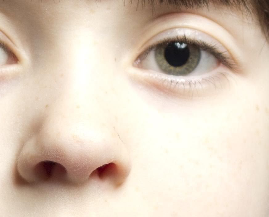

Dec 27, 2011 15:55 |  #7
thedcmule2 wrote in post #13606060 (external link)
No im far from pixel peeping - I wish I was :)
Its more apparent up close - look at the eye in the crop compared to the nose - now I was selected on the eye, yet the nose is more in focus.
IMAGE: http://i114.photobucket.com/albums/n255/DON-T5/IMG_2179crop.jpg

thedcmule2
1,125 posts
Joined Nov 2011
Dec 27, 2011 16:06 |  #8
I see it now. Your daughter isnt a statue, its possible she moved backward a half an inch and threw the whole thing off. Did you try a bigger dof?
