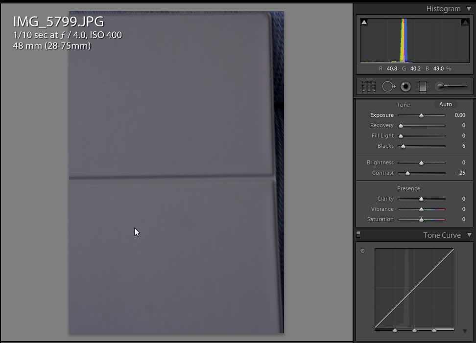

PhotosGuy wrote in post #13651158 (external link)
If you don't understand the histogram...
Here is a gray card, and histogram as it should appear...
IMAGE: http://i69.photobucket.com/albums/i63/wiltonw/18grayasmeteredat18.jpg
Here is a three tone target, and histogram as it should appear...
IMAGE: http://i69.photobucket.com/albums/i63/wiltonw/Meter18sun5025.jpg

Jan 05, 2012 11:00 |  #15
Not to complicate what we're trying to do in this thread, but the white doesn't come close to the right edge. Considering that 2048 levels of the info in the image is at the right side, I'd like to see the white farther over.
http://www.luminous-landscape.com/tutorial​s/expose-right.shtml (external link)
