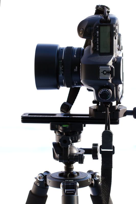

One of the perks to having no center column, is when you find something down on the ground you want to get your camera close to. A rig like this gets down to about 10.5" from the ground to the bottom of the camera.
IMAGE: http://i69.photobucket.com/albums/i61/rsamos/pnet/IMG_0056.jpg
All set up for taking stitched panoramic shots. The clamp comes off the top of the head so you can put it on the 'bottom' of the panoramic base. (shown w/ a Kirk rail)
IMAGE: http://i69.photobucket.com/albums/i61/rsamos/pnet/IMG_0051.jpg
In all its upside-down glory. Here you can see how the ballhead being at the bottom of the 'stack' allows you to level the pano base.

Nice. What rail are you using in the second picture?

That's the Kirk LRP-1 Long Rail Plate (external link).

That looks really promising. I just started researching rails for panaramics and macro use. The Kirk plate is $75 cheaper than the pano rail that Acratech sells (although I wonder if the adjustable stops on the Acratech would allow for faster setup for pano applications).

I was looking at the Acratech rail, and yea - the stops would make it faster to set up. But it wouldn't be by all that much - you'd be shaving a fraction of a second off of a fraction of a second. You need to judge for yourself if that's worth $75.
The Kirk rail has a numbered scale on it. I slip the rail into the clamp, aligning the "5" with the front edge of the clamp for the 50/1.4 and turn the clamp knob 1/2 turn - done. Takes something less than a second to line up the rail where it goes and tighten the clamp.
I've thought about the leveling bases. As far as function, it really doesn't seem like it would be any better than what I'm doing now. Maybe if I just left the base on the tripod all the time it would save me the time of moving the clamp, which I'll admit is a bit of a pain (but only a bit). But then I'd be taking this 3.2lb rig and adding something like another 1/2 lb to it. Not exactly what I had in mind when I picked this tripod and head up.
