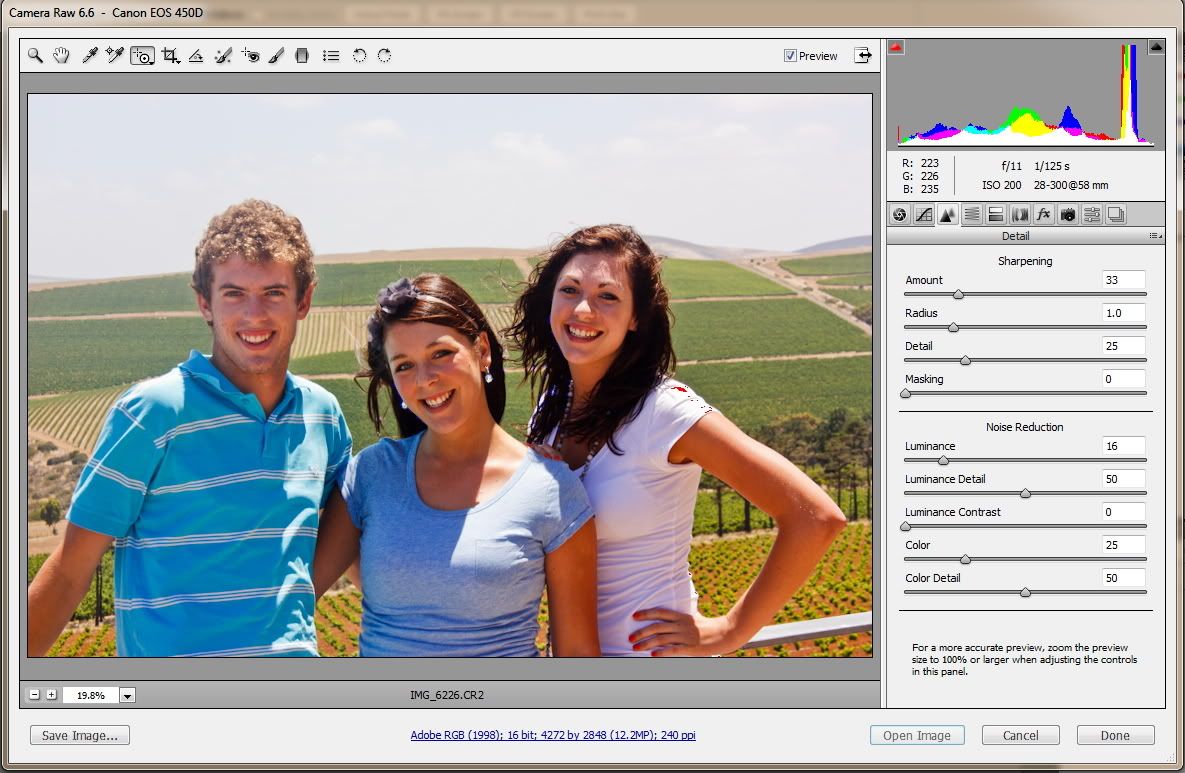

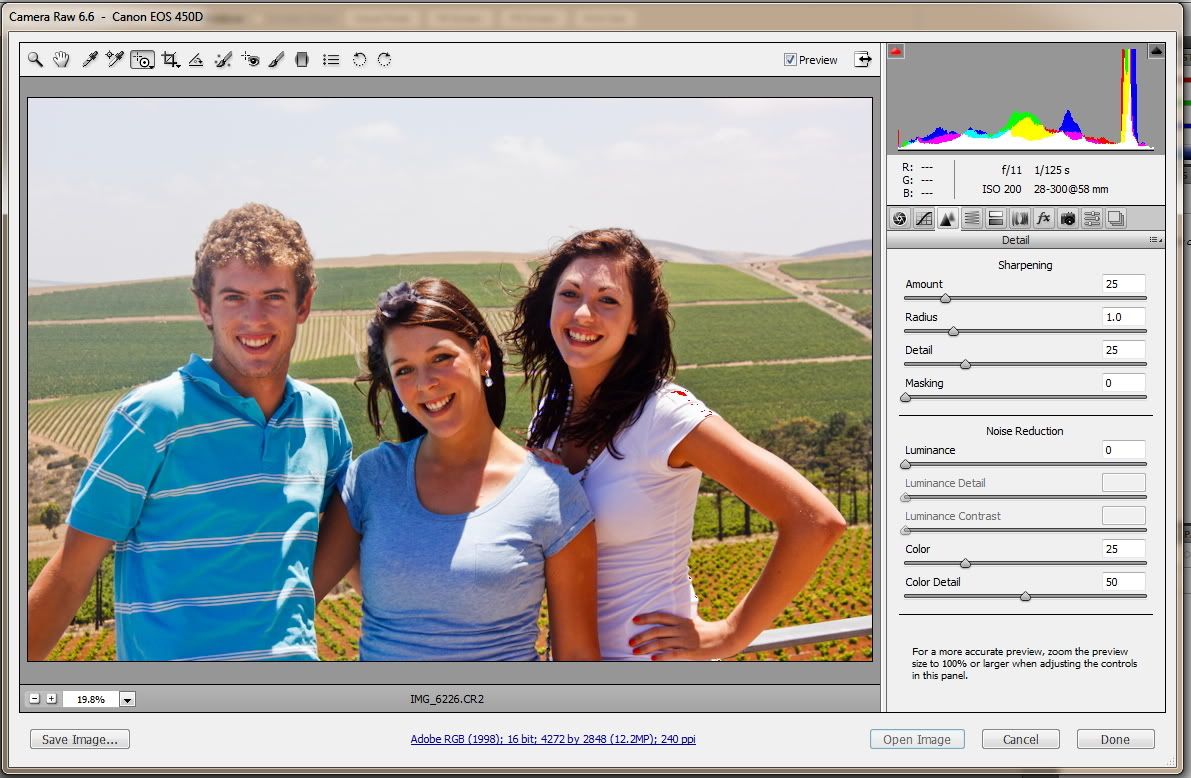

I have uploaded another image and played with it myself. I did not fiddle with my son's face, I think one can get it sharper and with less noise:
The links to the RAW image:
(not sure which one is working- it is image 6226)
https://rcpt.yousendit​.com …646dce1b3f26a08​703af1d970 (external link) https://www.yousendit.​com/folders (external link)

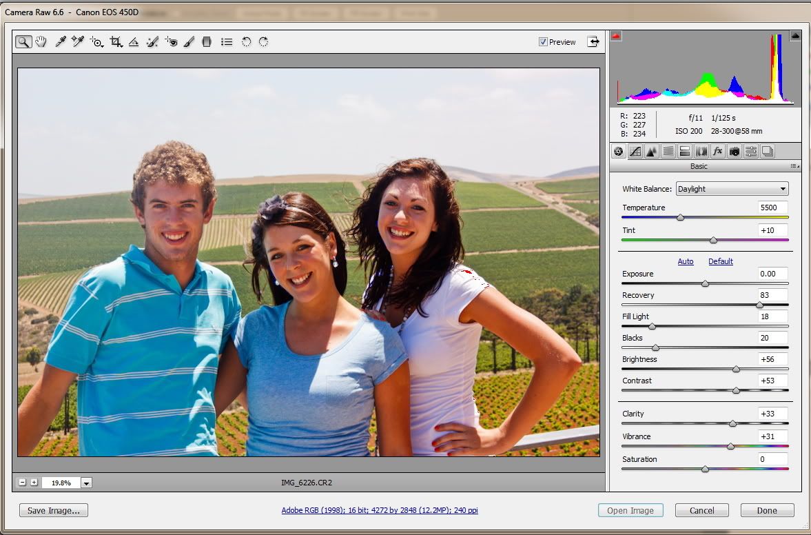

These are my edits- not aggressive:
Initial edit- pushed up Recovery, Light, Brightness, etc from the default settings.
http://i261.photobucke​t.com …vz10/2012-01-10180440.jpg (external link)
Default sharpness:
http://i261.photobucke​t.com …vz10/2012-01-10180722.jpg (external link)
Increased sharpness and moved luminance:
http://i261.photobucke​t.com …vz10/2012-01-10181036.jpg (external link)

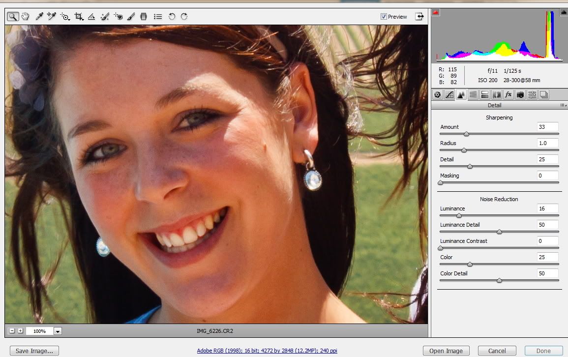

At 100%
http://i261.photobucke​t.com …vz10/2012-01-10214220.jpg (external link)
Used High Pass filter:
http://i261.photobucke​t.com …vz10/2012-01-10181319.jpg (external link)

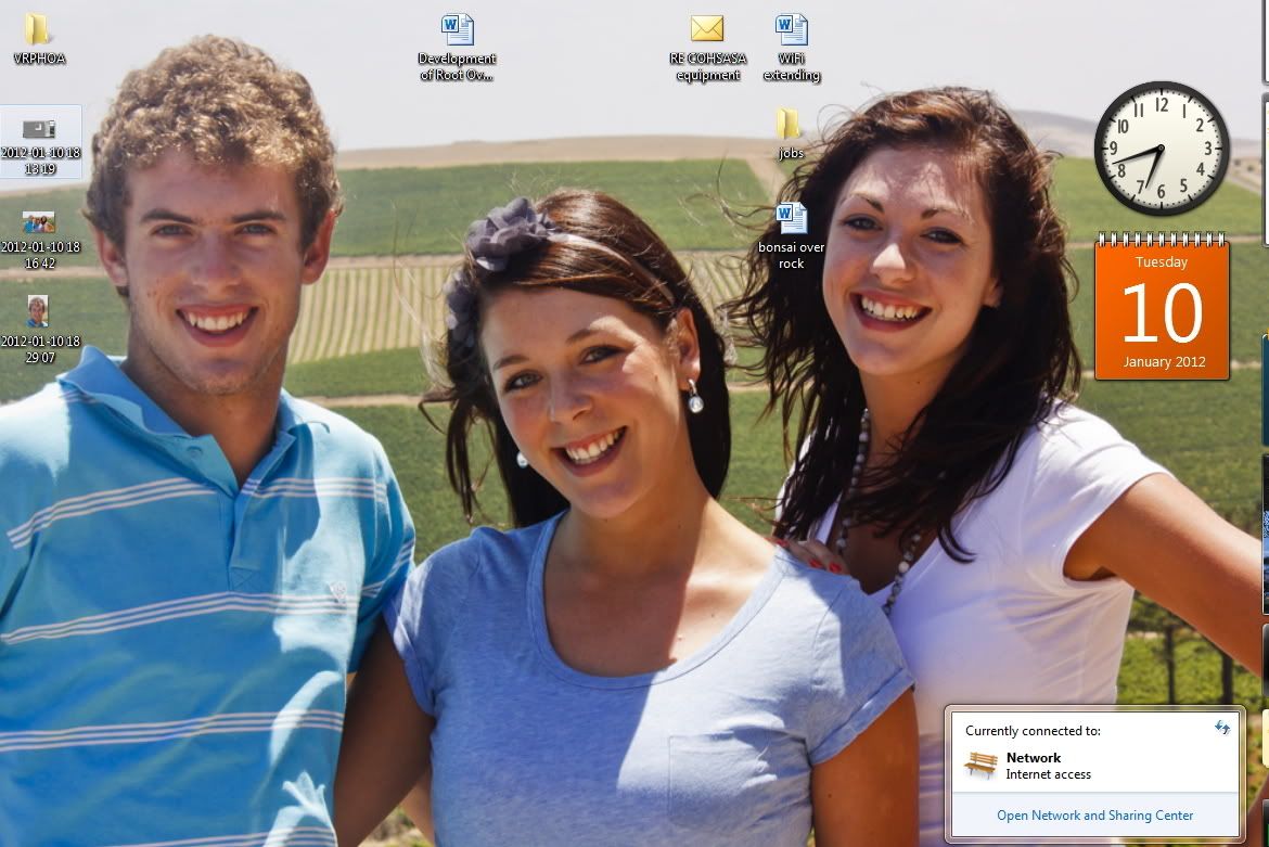

Noise in my son's face- but I did not try to work on his face.
IMAGE: http://i261.photobucket.com/albums/ii62/avz10/2012-01-10182907.jpg
Screen background set at 1600 by 900
http://i261.photobucke​t.com …vz10/2012-01-10184222.jpg (external link)
Any comments?
Should I have sharpened more?? But at least the screen does not have so much noise as my previous effort.

So, I downloaded your "desktop" Raw file, and when you leave your "develop" settings at the default (Lightroom or Camera Raw) the noise doesn't show at all, viewed at 100%.
**NOTE: See the post below to see the 100% crop compared to the enlarged version!
But this is an "enlarged" version of the 100% crop:
Now, that does not mean that the image "has no noise" -- all digital images have noise, but your "typical" low ISO shot has an exposure that lets more light in so that the inherent noise is "not noticeable".
But yes, you can crank things in processing, especially with a Raw file, that can bring noise to the "surface", even with a low ISO shot, and that is obviously what has happened here -- likely the Contrast and Clarity settings "overcooked" things.
If you want to figure this out, open the file in Camera Raw again and just take a step-by-step approach through each of your settings, viewing the image at 100%. You should find that at least one setting causes that noise to pop up. Such findings can be valuable for the future -- learn what to avoid and alternative ways of processing!

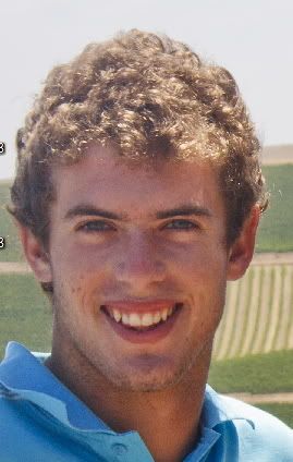

OK, in my earlier post the large version came up. Let's do this again:
Here is a 100% crop where the noise is not noticeable:
Here is the enlarged version, where of course you see not only some noise but the "pixellation" from being enlarged beyond 100%:
Tony
