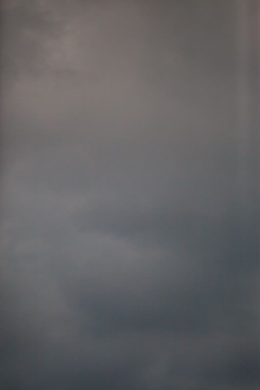

Jan 22, 2012 14:36 |  #11
Before the shutter of my 5DII passed away, I got this kind of bright stripe on the side of the frame at high shutter speeds (this one is @1/8000) :
IMAGE: http://i785.photobucket.com/albums/yy134/ouessant/tests/8000.jpg
François
