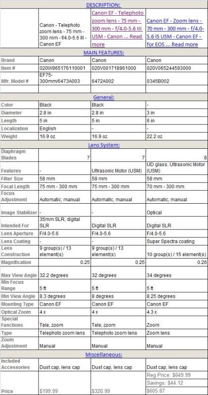

OK, so money is a bit tight right now, but I wanted to pick up a cheap zoom lens just to play around with and learn how to use it. What are the significant differences between these three (other than cost)? Am I wasting my time and money buying one of these right now? Thanks!
IMAGE: http://i11.photobucket.com/albums/a198/st0rmbr1nger/00lenses-1.jpg
