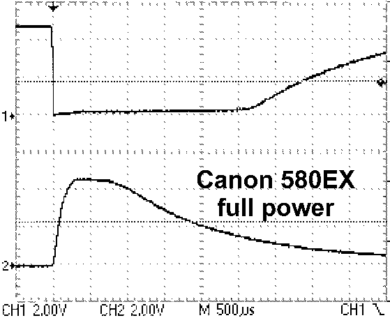

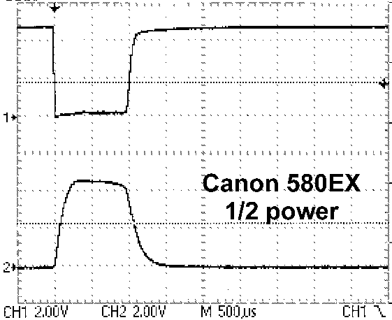

Longer duration of the light. A full power discharge take a lot longer than half power. So if you are trying to avoid motion blur then don't go higher than half power.
IMAGE: http://i144.photobucket.com/albums/r174/hydedj/ebay%20trigger/9a.gif
IMAGE: http://i144.photobucket.com/albums/r174/hydedj/ebay%20trigger/8a.gif
