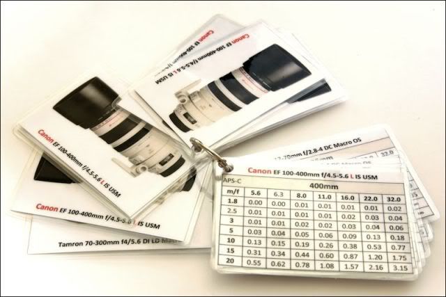

After last weekends visit (first good light for the new 100-400), I was dissapointed with my results - the majority of the photos being out of focus. I did a bit of research which suggested I was getting too small a depth of field.
The EXIF was revealing I was shooting at f5.6 with the lens at 400mm. Standing about 4m from the target, my DOF was 20mm (http://www.dofmaster.c​om/dofjs.html (external link)).
During the week, using the formula found on that website, I wrote an excel spreadsheet to generate DOF for my selection of lenses, their f range and marked focal lengths. The results were pasted into MS Publisher, printed and laminated:
IMAGE: http://i243.photobucket.com/albums/ff140/Trugga_bucket/canon/KeyRing.jpg
OK, so there are other ways (phone apps etc), but at least the exercise gave me a better understanding of DOF.
To summarise what I learnt, is that the longer focal length at a shorter distance reduces the DOF. To increase the DOF, I needed a smaller aperture, which then reduced the shutter speed, so the ISO had to go up - the trick is, I belive, is to find the correct ballance.
