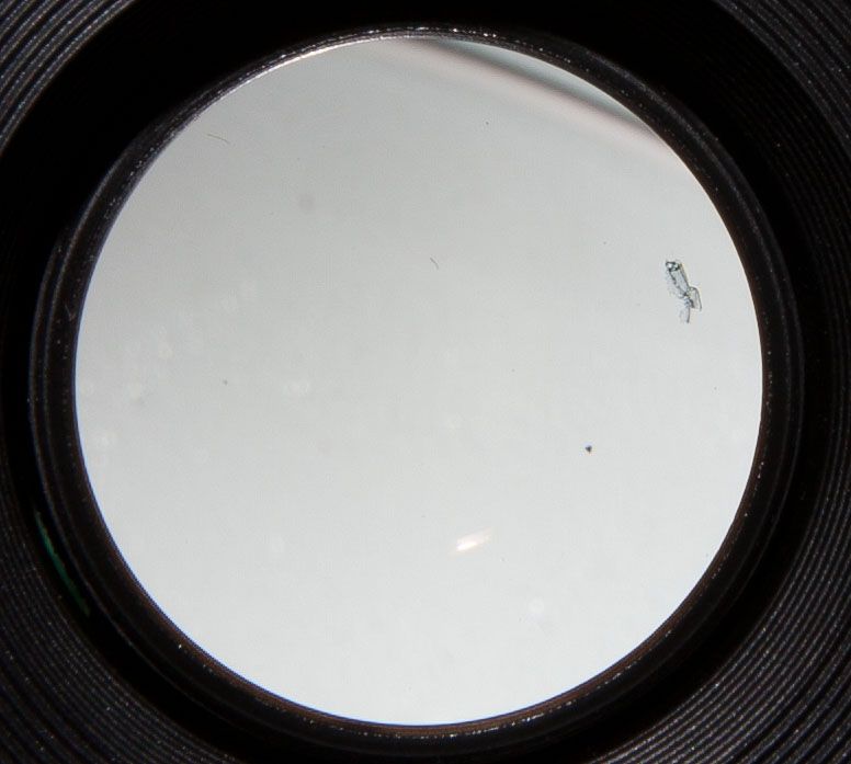

Feb 18, 2012 19:22 |  #9
Here's what it looks like, I also now see some white circle dots in the lens if you stare hard.
IMAGE: http://i7.photobucket.com/albums/y266/RockinVixen89/fungus.jpg

wuzzittoya
2,551 posts
Joined Aug 2011
Location: rural Missouri
Feb 18, 2012 19:25 |  #10
I'm going to stay-tuned... maybe fungus lens pictures I've seen have been much worse than this - it doesn't necessarily look like a fungus lens to me.  ???

ItsJustEd
433 posts
Gallery: 6 photos
Likes: 20
Joined Jan 2012
Location: St. Petersburg FL
Feb 18, 2012 19:29 |  #11
Oddly enough,it looks like a chip in the glass. Is that even possible to happen on the inside of a lens?

Vixen89
4,528 posts
Location: D-Town, TX
Feb 18, 2012 19:31 |  #12
Sorry it is visibly white and not black ..just like Ed said, it is inside the glass and not on the outer surface at all. I don't know how it is either.

wuzzittoya
2,551 posts
Joined Aug 2011
Feb 18, 2012 19:43 |  #13
I can see the white spots on the edges, but I thought fungus was this feathery-patterned type thing that covered your lenses...? I thought that I saw a chip too, but since it wasn't part of the discussion - is the chip looking thing where the fungus is?

macroshooter1970
7,494 posts
Location: Arizona
Feb 18, 2012 19:46 |  #14
Hard to tell from the picture, not saying yes or no. I never seen lens fungus look like that so far? It's always fury looking lol. How's it look if you shine a flashlight through it.

Feb 18, 2012 19:48 as a reply to  @ Vixen89's post |  #15
Hard to tell from that picture what it is, could be a fibre of some kind or could be fungus.
I trade, repair and service classic lenses as a hobby and see a lot of fungus. I also service and repair some of the newer lenses and fungus does come in all shapes and sizes, but so do lose fibre particles.
If you can take a shot with light shining through the opposite end of the lens and tilt the lens so that the object is question is againt the inner body of the lens, it will probably be easier to see what it is.
And yes it can easily be on the inner elements of your lens.
Got to say these newer fangled lenses don't have pretty fungus, here is one with fungus that looks almost crystal like and has a large amount of spores in the lens
Heres some 'classic' pretty fungus
