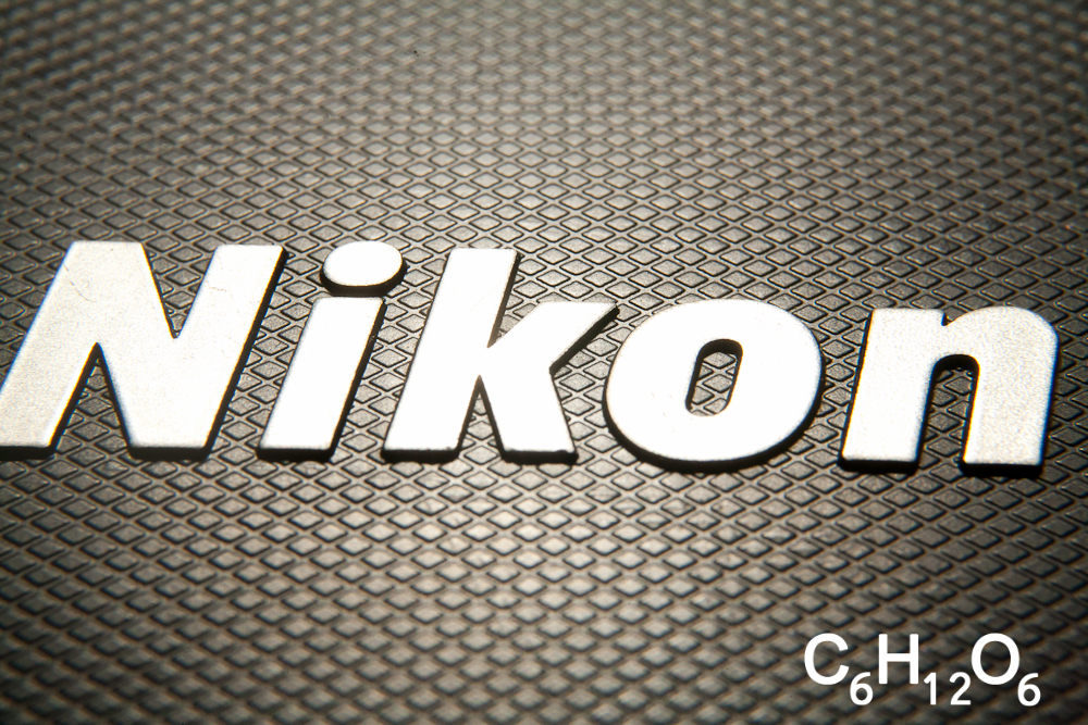

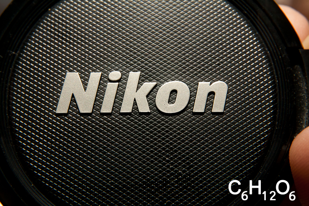

Quick sample. 58mm Nikon cap, lighting was a 540ez manual mode @ 1/8th power
28mm f22 according to exif.....could have sworn these were f9
IMAGE: http://www.guvmentcheese.com/jd0gg/photos/macro/cap.jpg
50mm
IMAGE: http://www.guvmentcheese.com/jd0gg/photos/macro/cap2.jpg
Wide-open it has a little CA and ZERO DoF. Stopped down it's pretty decent.

wow that looks pretty damn sharp for the modded lens...how to do!?

That's really a painful amount of CA though, I doubt it'd be useful for serious macro work - if you compare it to dedicated macro lenses.
The wide angle (if it's still a wide angle) is fun though!
