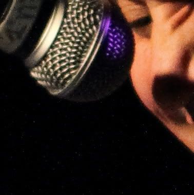

I'm actually not sure what it is...noise is the only word I could think to describe it. here's a sample...
IMAGE: http://i28.photobucket.com/albums/c204/careysean/IMG_0356.jpg
That looks more like noise, are you using Canon's DPP ?

Yours is not a hot pixel problem... it's an excessive noise problem. The hot pixel fix won't resolve the problem. Some 7D just seem to have excessive noise, so let the shop send it to Canon and see if it can be fixed. If not, they should exchange it.
One thing you might try before sending it in is be sure to update the firmware to the latest and greatest. Sometimes these things are fixed that way. But I doubt it because I've seen a few 7D that seem to simply be noisy and the only fix is Canon repair or replacement.

I am. once I converted it to a jpeg, I opened it in photoshop elements and saw it there too.
