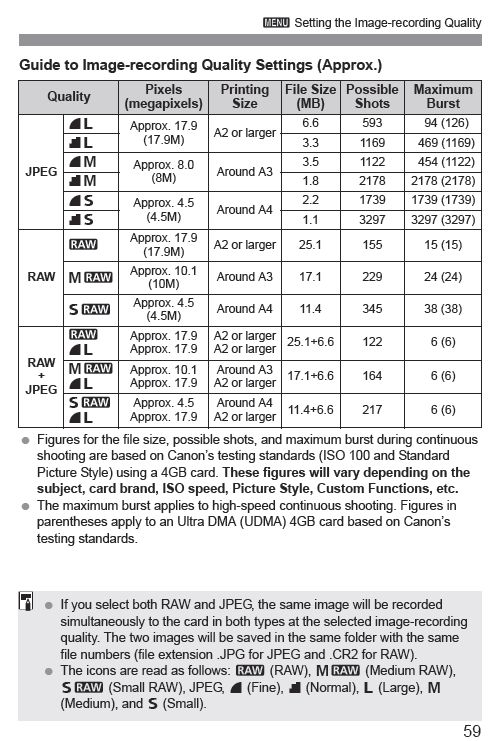

The 7D supports UDMA 7, but only if the latest 1.2.5 firmware has been installed. Check your 7D when you get it. http://www.learn.usa.c​anon.com …6_eos7d_firmwar​e125.shtml (external link)
You should get at least a 8MB CF card if you shoot RAW. 16GB or 32GB might be preferred due to the the large file sizes from the 18MP sensor.

7D manual on file size and capacity with a 4GB card
IMAGE: http://i2.photobucket.com/albums/y17/msowsun/photo%20stuff/Photo8/_02a-4.jpg
