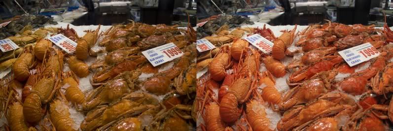

However, I discover that when I open my raw files using PS CS5, the colour is very different with what I saw when I open in Canon DPP and FastStone Image Viewer.
The colour of Canon DPP and FastStone Image Viewer are almost same but PS CS5 will actually alter my colours
I am very sure this is not the white balance's problem as I have tried to applied same WB to all 3 programs, and only CS5 looks different
Example....red become yellowish
(left is converted via CS5, right is converted via Canon DPP)
IMAGE: http://i37.photobucket.com/albums/e58/neoroxx/photoshop_DPP.jpg
I did not make any changes for both pic above, I just open in CS5 and convert to jpeg and another one is open in Canon DPP and convert to CS5....
Can anyone teach me how to fix this?

When you shoot a Raw the camera also makes a jpg version which it embeds into the Raw file. This is because a Raw is not a color image file and therefore cannot be displayed. The jpg is processed according to the settings in the camera and is used for the LCD display. When you "open" a Raw file in the Faststone viewer it also actually uses that jpg, that is what you are seeing. When you open the file in DPP it reads the list of camera settings that is also embedded in the file (the metadata) and processes a preview display that is very close to that jpg. That's why DPP and Faststone look alike. The PSCS5 Raw converter, ACR, doesn't read the metadata, other than the WB, and uses its own default processing instead. The defaults are supposed to be only a starting point and you are free to make any changes that you think will improve the image.

Adobe will just give an "approximation". In your Raw processor/converter, you can set the White Balance to please yourself.
FastStone will use the "embedded jpeg" to view the file, so that it will match what you see in DPP. Adobe will use its own process to render the file from the Raw data.
You might also want to check out your Color Space setting in Camera Raw. If you look at the little link below your preview, you will see a Color Space setting as well as either 8 bits or 16 bits -- these can be changed by clicking on the link. For example, if you want only sRGB images, Camera Raw could be converting to aRGB -- check the link and change if needed!

In a sense it's a difference in the philosophy of what a starting point should be. For creating a jpg the camera needs to use a level of processing that produces a finished product. By using that same processing as its default, DPP also starts with something that is pretty highly edited. At Adobe they think that if someone has decided to use Raw it is because they want to make all the decisions (or at least most of them), so they default to a more neutral, half-way sort of processing which doesn't point as much in a particular direction.
But Adobe also recognizes that some people will want to save time by having defaults that have already done most of the work, so they made it very easy to change the defaults. Set the Camera Profile with the same name as the Picture Style you have set in the camera, experiment with increased Contrast, Saturation or Vibrance and Sharpening, maybe some Brightness, add in Clarity - experiment until you have found the level of editing that looks like DPP and then make that your new default. From then on all your photos will start with that editing.

In ACR go to the "Camera Calibration" tab and make sure you are NOT using ACR 4.6 or Adobe Standard as your camera profile. The ones that start with the word "Camera" such as "Camera Standard" should be used as these are specific to the camera the Raw file is coming from and are meant to emulate the profiles by Canon, Nikon and the other manufacturers.
Also, the image you posted is aRGB not sRGB ... so if you believe you are set up for sRGB something is wrong. You set up the conversion from CR2 to sRGB in ACR.
Yours will be different than what I show in the following image since these are for my Nikon D700:
