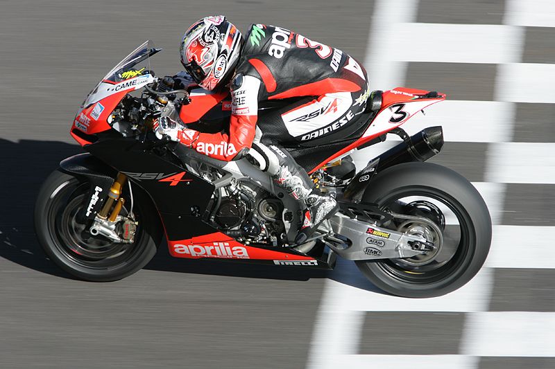

I'm working on my motorsports photography too and have a few questions. I'm trying to get my panning technique down and I'm not doing too bad at it but what I'm not clear about is when you pan, or do you pan all the time in some way, shape or form? I like to get the wheel blur but get everything else crisp.
I have attached 4 photos (these are actually me on the bike at a track day). These were taken by a photographer who has done a number of track days and they turn out good and I would like mine to look this way as well.
Photo's 1 and 2 are what I'm trying to nail down. Bike and rider are still, but wheel blur and very minimal side to side background blur. I can only assume that these were taken somewhere are 1/400 or so shutter speed, but not sure? The part of the track where these were taken is fairly slow speed (35mph) so does that contribute to an easier shot, but I'm assuming when taking this shot you still have to pan or "track" the rider, snap the pic and follow through with your pan? The third photo is a higher speed section of the track, probably 60-70 mph, so at the same shutter speed but having to pan faster gets the background more blurred? The last photo is one that confuses me, I believe this is coming out of a very low speed turn on the track (around 15mph). I notice very little background blur in relation to panning, but there is some blur due to depth of field. If you look at the front brake disc, you can see that there is motion blur there, so I'm wondering how this shot was captured to again get the bike and rider crisp, but still get the blur in the wheels?
Thanks in advance to any advice you guys can give, greatly appreciated

flyinlow007 wrote in post #14350073 (external link)
I think you pretty nail it on your thoughts on how these were likely taken. Panning is certainly easier when the object is moving more slowly, and when it's moving across (roughly) the same plane relative to the photographer. It's also harder to pan at longer ends of the zoom, since any roughness in the motion will cause the object to move around in the frame more. As a few people have pointed out, be ready to shoot quite a few frames even after practice. Lots aren't keepers.
