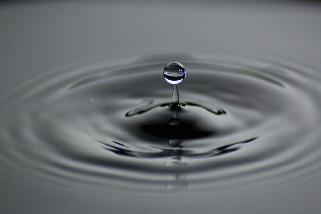

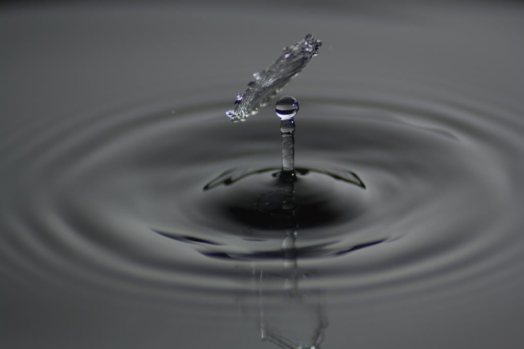

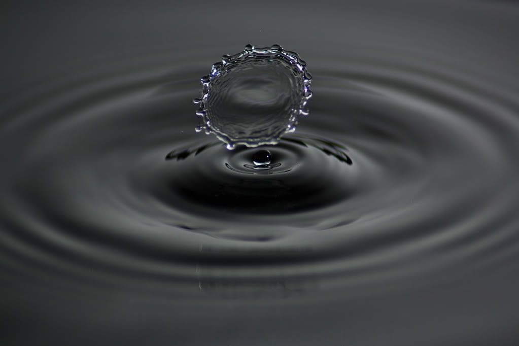

My second attempt at water drops, finaly got some I like. let me knwo what you think, I didn't Photoshop them just adjusted ballance a touch. anypointers on how to Process them I'm all ears. thanks
IMAGE: http://i1250.photobucket.com/albums/hh521/McMongoCanon/WaterDrops3014_edited-1.jpg
IMAGE: http://i1250.photobucket.com/albums/hh521/McMongoCanon/WaterDrops3093_edited-1.jpg
IMAGE: http://i1250.photobucket.com/albums/hh521/McMongoCanon/WaterDrops3186_edited-1.jpg
IMAGE: http://i1250.photobucket.com/albums/hh521/McMongoCanon/WaterDrops3341_edited-1.jpg

Those are great. I have attempted this a couple times and didn't get anything close. I like the last one w/ the multiple colors underneath and then the next to last one too b/c of the shape of the water falling.

very nice!

Very cool photos. I like #1 and #3, but all very nice!

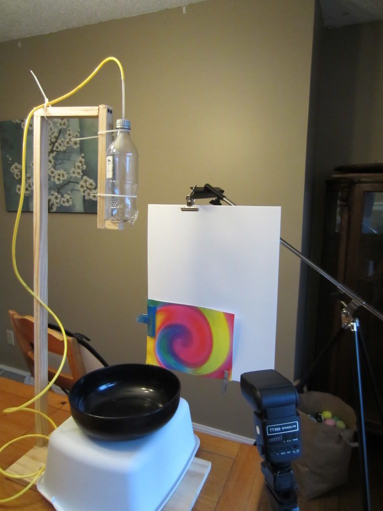

agreed. I like them I never get close to that either. Care to post a shot of your setup? Most interested in workin distance between water and camera.

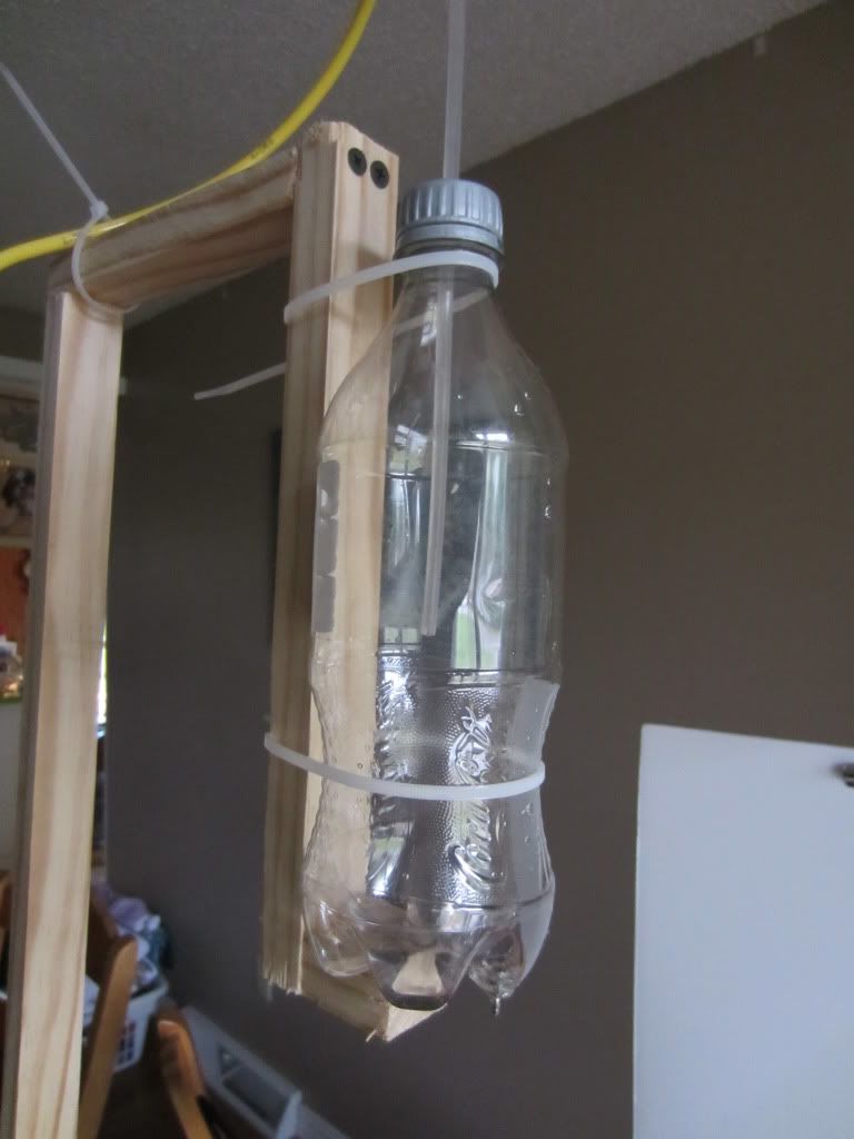

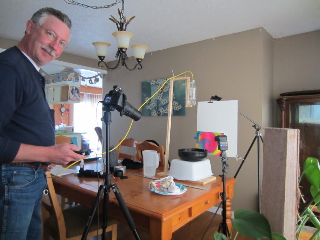

Here's my set up.
I'm shooting f-5.6, SS-200, ISO-100 Focal Length-183mm.
Set camera up about 2 inches farther back than the minimum closest focal distance. Tried to get water to drip at a rate of 10 drops per second.
The yellow tube I used to manually start and stop water flow, release to allow drops, closed off with my thumb to stop or pause water drops in order to let water in the bowl to settle down between shots.
Single flash bounced off back board set at 1/64 or lowest power.
Other than that it’s just timing and a lot of exposers.
NOTE: the water bottle setup is a Mariotte Siphon, Google it. This allows you to control water drip rate. I used a 1/8” Nipple fitting for the drip nozzle.
Hope this helps conquer the water drips.

Also, what lens is shown in your set-up pics?
