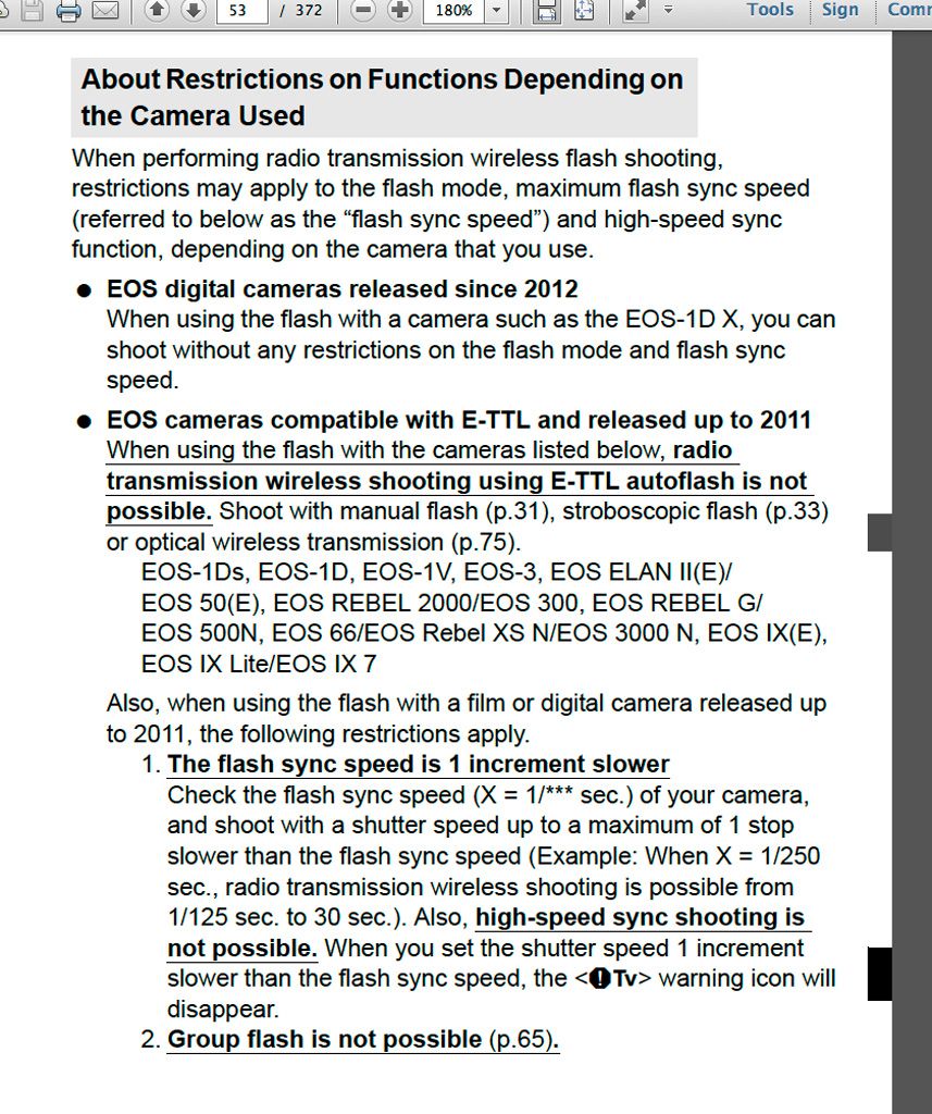

I have both the 5D3 and 7D. With a 5D2 you will not have group mode because it is a pre 2012 release date. Group mode is very cool as you can shoot group A in ETTL, group B in Manual and so and have complete control via the flash LCD or camera LCD. You don't have to walk to the flashes to change power
I just tested my 600's on my 7D which is pre 2012 production. I was able to control the off camera 600 in ratio mode using "radio mode". Worked perfectly in Manual mode so you can adjust the off camera flash without walking there. You get 3 groups A, B and C. In manual it is not actually a ratio, you adjust output for each individual flash.
It appeared to work on ETTL as well but it was hard to judge the output. Ratio came up with the old A:B then C for a third flash. I never used ratios so I'm not an expert but if it worked in manual in radio mode then it should work in ETTL.
I can adjust groups and everything else via the camera LCD or flash LCD on my 5D3. I could only access ratios via the flash LCD when on my 7D. Today was the first time I have ever tried that on my 7D. Always use multiple flashes with the 5D3. Hope this helps.
From the 600 manual.

Sorry I missed this part of your question. It states in the manual that I posted states that you lose one increment with a pre 2012 camera. However I have read a few posts where people are saying that they can achieve sync speed. That I did not test.

In Radio mode, Sync Speed works just fine at Camera Sync, Canon 7D 1/250 for example.
HSS also works in pre 2012 Camera Bodies.
Unfortunately, manual is correct stating Group Mode does NOT work in pre 2012 camera bodies. RATS!

Nick5 wrote in post #16269979 (external link)
That I can verify because I tested it last night. As soon as I pressed the shutter it defaulted back to ALL from Group.

In the Spring of 1012, I bought my first 600 EX-RT and ST-E3 transmitter I was disheartened to read about the 3 scenarios on pre 2012 bodies as I have 7D bodies.
At first I was let down figuring I could live with it. That lasted about three minutes in the store until I decided to see if all three were true.
Maximum synch speed on canon 7D 1/250. Worked just fine in Radio.
High Speed Synch. Worked just fine in Radio also
Group Mode RATS! Does not work
To this day all is true for me and many, many others that have this wonderful radio system.
Dispelling two of three Myths is fine with me.
