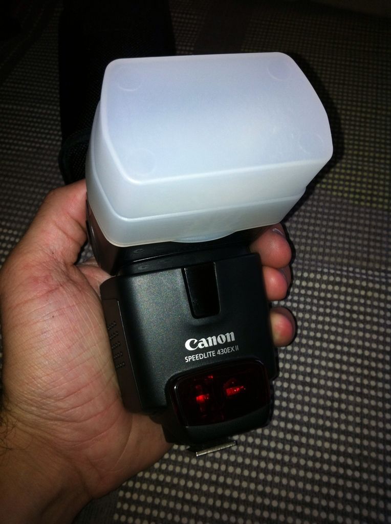

May 07, 2012 08:46 as a reply to  @ SJRobbins's post |  #4
IMAGE: http://i1222.photobucket.com/albums/dd482/delkovd/f2df2c0b.jpg
Ok so ill remove the diffuser then.

Those diffusers to practically nothing for you, except where you can bounce flash. And if you can bounce flash, then you dont need one if the first place. So ditch the plastic, its just eating power for no efffect.

All that diffuser does is send your light in every direction at once, it doesn't "soften" it at all. If you're bouncing it off walls/ceilings they can be useful on camera, but if the flash has a catch light card then I'd prefer that if I was bouncing personally.

Ditch plastic.
Get umbrella or softbox instead.
Get ettl extention cord or speedlite transmitter (as by link)
Use 430 ex diffusing plastic card.
