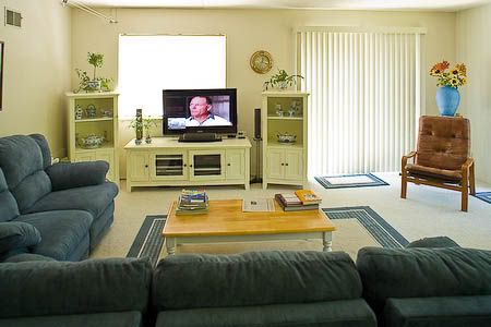

I've posted this image before on POTN to illustrate other points. Now I'll use it again to illustrate photographing a 14' x 20' interior area with a FF camera with 24mm PC lens...
IMAGE: http://i69.photobucket.com/albums/i63/wiltonw/120cmshift.jpg
