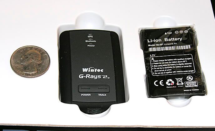

May 20, 2012 09:19 |  #13
Wintec G-Ray 201. (external link)
The size of a quarter, 10 hr battery rechargable. It marks locations by time code. Set your camera's clock to the local time or GMT. Upload photos at home to your computer. Use Geobabel (free software) to lock your photos to the Wintec log long/lat coordinates via time codes. Use Geosetter (free software) to locate the coordinates of each shot on Google Maps.
Contribute to the two software sites, the apps are fantastic. Have used the system for two years, many trips.
