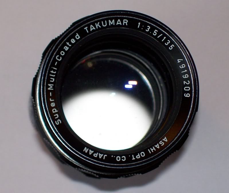

Jun 04, 2012 15:36 |  #12
Is that really a 135mm f1.4 lens?

Jun 06, 2012 21:28 |  #15
There are no 135mm f1.4 lenses, that was a typo. You have a 135mm f3.5.
IMAGE: http://i90.photobucket.com/albums/k245/Andrewr05/Pentax/pentax7.jpg
A 135mm f1.4 lens would be very impressive, very fat, and very expensive.
