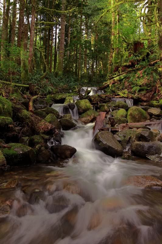

This shot was
ISO-50
f/13
1/2sec shutter
IMAGE: http://i257.photobucket.com/albums/hh239/kawi_200/Cities%20and%20Skylines/_MG_1110.jpg
