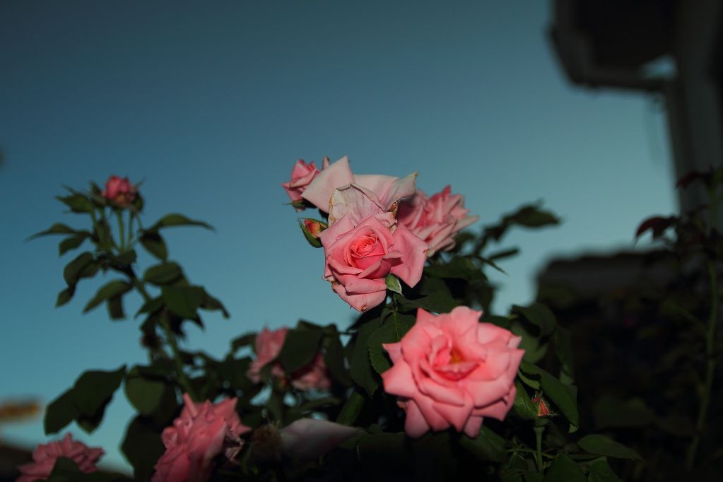

The last thing I tried was attaching my CPL on my Sigma 17-50 and then attaching the ND400 on the front of that. I have not read anywhere that stacking the Marumi Variable ND with a CPL was advises, suggested, or even possible, but being adventurous I decided to see how bad IQ would be degraded.
The sun was just dipping behind my neighbor’s house, so I moved over to a rosebush, opened up my lens to f/2.8 with a focal length of 28mm, setting my SS to 1/200 and used the popup flash. I only took one shot with these settings but you can see from the results below that it is indeed possible to stack the ND400 in front of the CPL giving you more than 10-stops.
IMAGE: http://i1103.photobucket.com/albums/g463/Roc34ky/Neutral%20Density%20Photographs/Stacked_Filter.jpg
Overall I am very pleased at the initial performance of the Marumi ND2-ND400; $130.00 USD seems a very good deal for the hobbyist like me. I will continue to do more extensive testing with my other lenses, to see how well it performs between 10-200mm.
