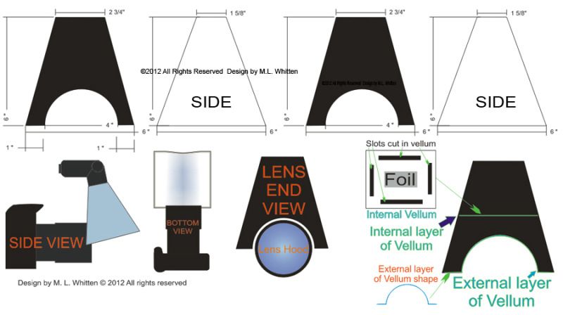

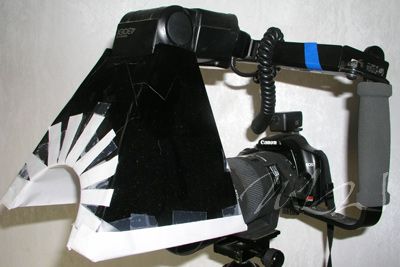

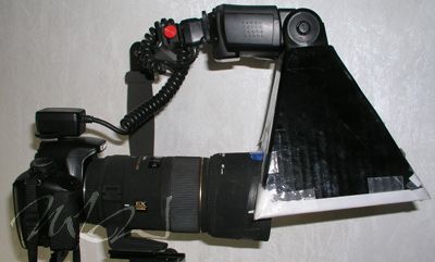

Here are the plans that I drew up for my Wrap-around diffuser. It is designed for the Canon 430EX Speedlite.
IMAGE: http://img.photobucket.com/albums/v714/DeepWoodsDecals/Macro/Diffuser/Diffuser-2-Vector-plans.jpg

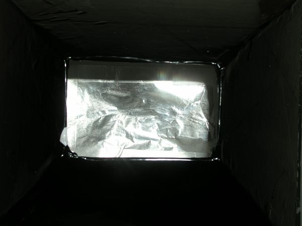

Looking inside...I used a piece of aluminum foil placed in the center of the inside layer of vellum.
IMAGE: http://img.photobucket.com/albums/v714/DeepWoodsDecals/Macro/Diffuser/Diffuser-2_inside.jpg
Looking inside where the flash is inserted.
IMAGE: http://img.photobucket.com/albums/v714/DeepWoodsDecals/Macro/Diffuser/Diffuser4_inside_foil.jpg

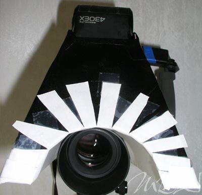

Front angle view
IMAGE: http://img.photobucket.com/albums/v714/DeepWoodsDecals/Macro/Diffuser/Diffuser-2_front_angle.jpg
Side view
IMAGE: http://img.photobucket.com/albums/v714/DeepWoodsDecals/Macro/Diffuser/Diffuser-2_side.jpg
Front view
IMAGE: http://img.photobucket.com/albums/v714/DeepWoodsDecals/Macro/Diffuser/Diffuser-2_front.jpg
