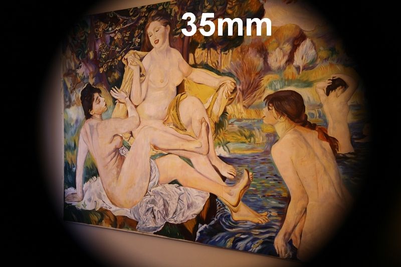

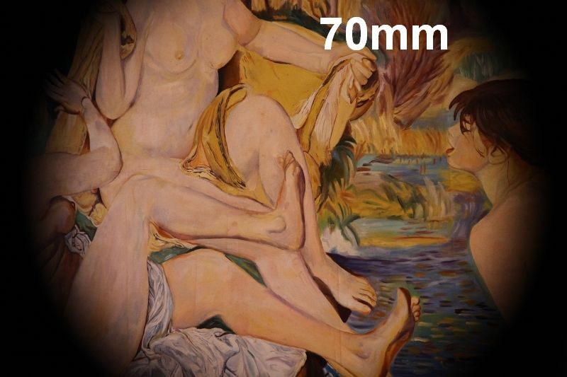

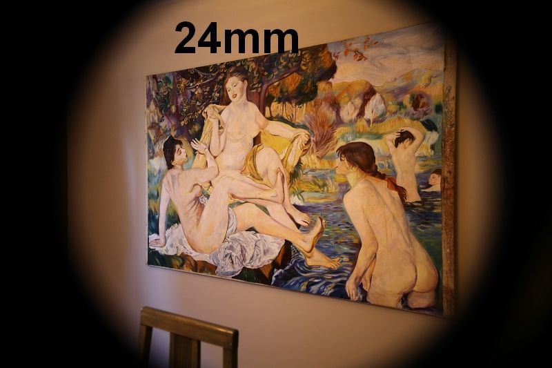

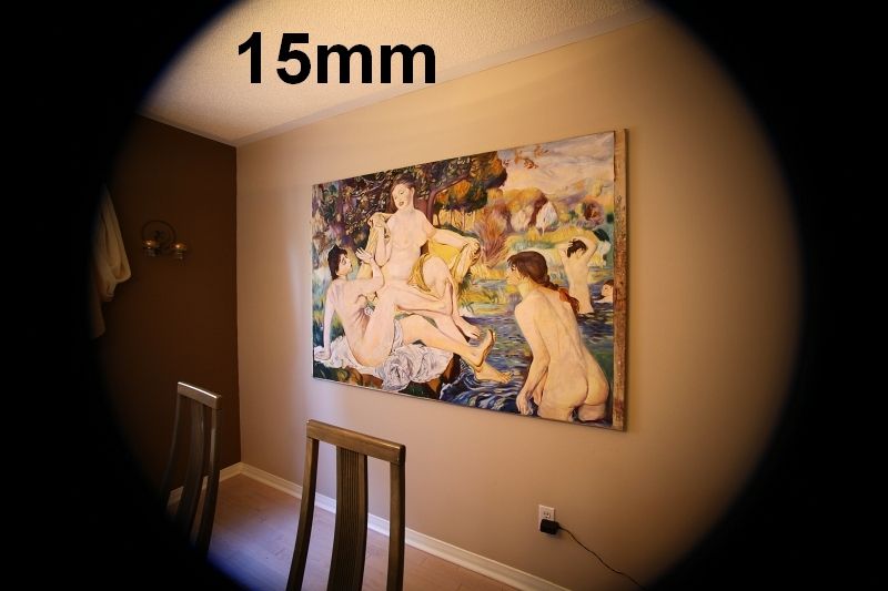

I tried my EF-S 15-85 on my 5D Mk II with these results:
IMAGE: http://i2.photobucket.com/albums/y17/msowsun/photo%20stuff/Photo8/IMG_9195.jpg
IMAGE: http://i2.photobucket.com/albums/y17/msowsun/photo%20stuff/Photo8/IMG_9196.jpg
IMAGE: http://i2.photobucket.com/albums/y17/msowsun/photo%20stuff/Photo8/IMG_9197.jpg
IMAGE: http://i2.photobucket.com/albums/y17/msowsun/photo%20stuff/Photo8/IMG_9198.jpg
IMAGE: http://i2.photobucket.com/albums/y17/msowsun/photo%20stuff/Photo8/IMG_9199.jpg
IMAGE: http://i2.photobucket.com/albums/y17/msowsun/photo%20stuff/Photo8/IMG_9200.jpg
