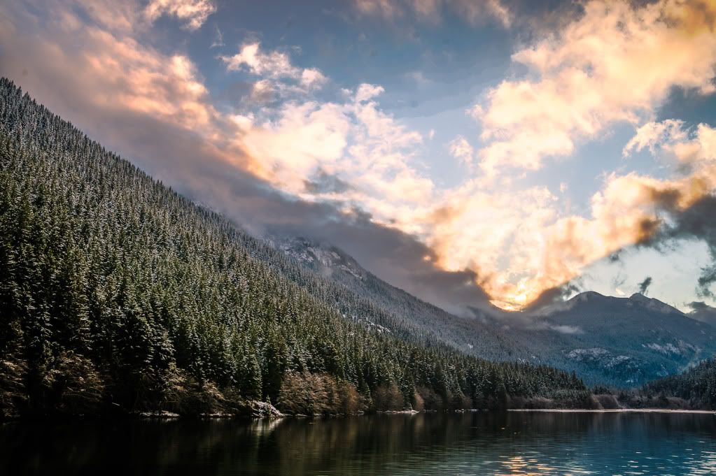

Hi there!
I'm finally trying my hand at HDR, and have been struggling with some sky banding issues with a sunrise shot. Some things I've tried to resolve this:
1) I've tried using different HDR sets from various times during this morning, and all are giving me the same banding issues.
2) I've also tried using 16bit mode- same issue
3) Removing ghosts makes the sky turn all grey - no good
4) Using just the +2, and -2 frames looks very grey also

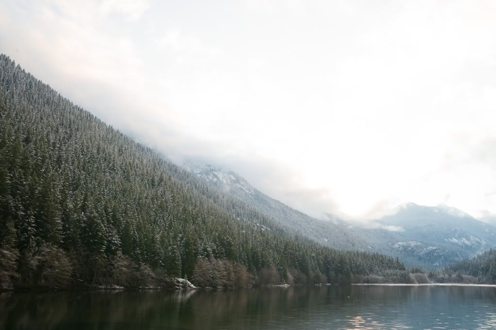

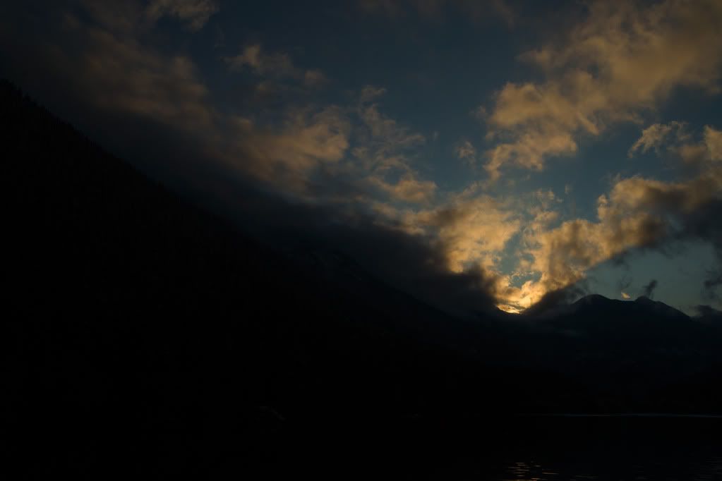

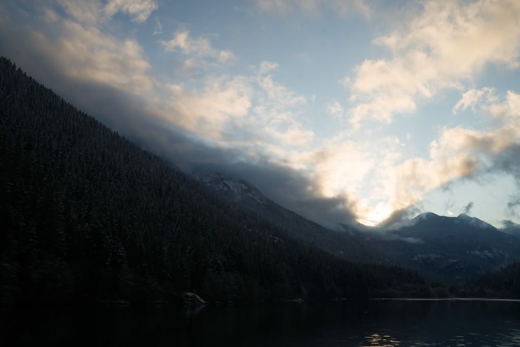

For each bracket set, I exposed at 0, +2, -2 EV. I was using a tripod and cable release.
For HDR merging I am using CS5's HDR PRO in 32bit mode, and editing in LR4.1. Banding is visible from HDR PRO, and shows up in LR as well.
Can any of you help with this? Should I have taken 5 frames, 1 stop apart instead? Is the dynamic range too high here?
Here is the final result from LR (note the noticeable banding in the sky):
IMAGE: http://i793.photobucket.com/albums/yy219/Engreeks1/EricLew-November192011-04.jpg
Here are the original frames:
IMAGE: http://i793.photobucket.com/albums/yy219/Engreeks1/EricLew-November192011-03.jpg
IMAGE: http://i793.photobucket.com/albums/yy219/Engreeks1/EricLew-November192011-02.jpg
IMAGE: http://i793.photobucket.com/albums/yy219/Engreeks1/EricLew-November192011-01.jpg

Jun 24, 2012 02:46 |  #2
Banding shouldn't be an issue with those. Just for gits and shiggles, try it in the photomatix light trial set to default or auto. Then process it in LR and see what you get.

Jun 24, 2012 03:01 |  #4
The banding is from the software processing. Photomatix can cause banding too if youre settings are not right, but its easier to control than photoshops hdr function.

Jun 24, 2012 06:37 |  #6
It seems that the banding is generated in CS5. For example, the following image has been processed in SNS-HDR Pro.

Jun 25, 2012 09:26 |  #8
Shoot with a tighter EV spacing to avoid the merger error in PS.
