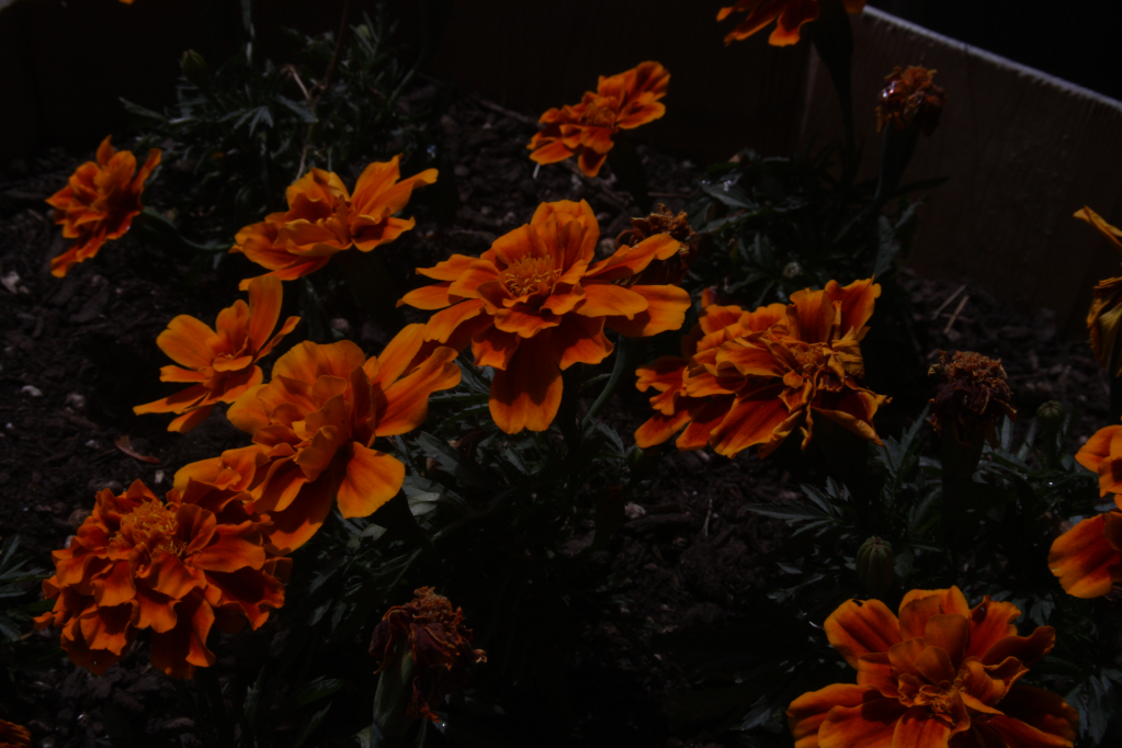

Recently my camera (Canon Rebel XSI 450D) seems to be having problems getting enough light, even in conditions where there appears to be plenty of light. The most recent example of this was during a recent trip where we had a cloudless day, with lighting that would normally cause overexposure. I had my iso set to 100, with an F. stop of 4.0, and the highest shutter speed I could get without the photo being underexposed was 1/100. I believe I would have to be standing on the surface of the sun to get the 1/4000 that the camera is capable of ;). Granted I realize that I could have increased the iso, but something seems off with my camera. I have always seemed to have trouble getting any kind of decent shutter speed with this camera, without the light being quite bright. Any time the light is "ideal" for photography, it always seems to be too dark for my camera to achieve a shutter speed high enough to prevent blurring.

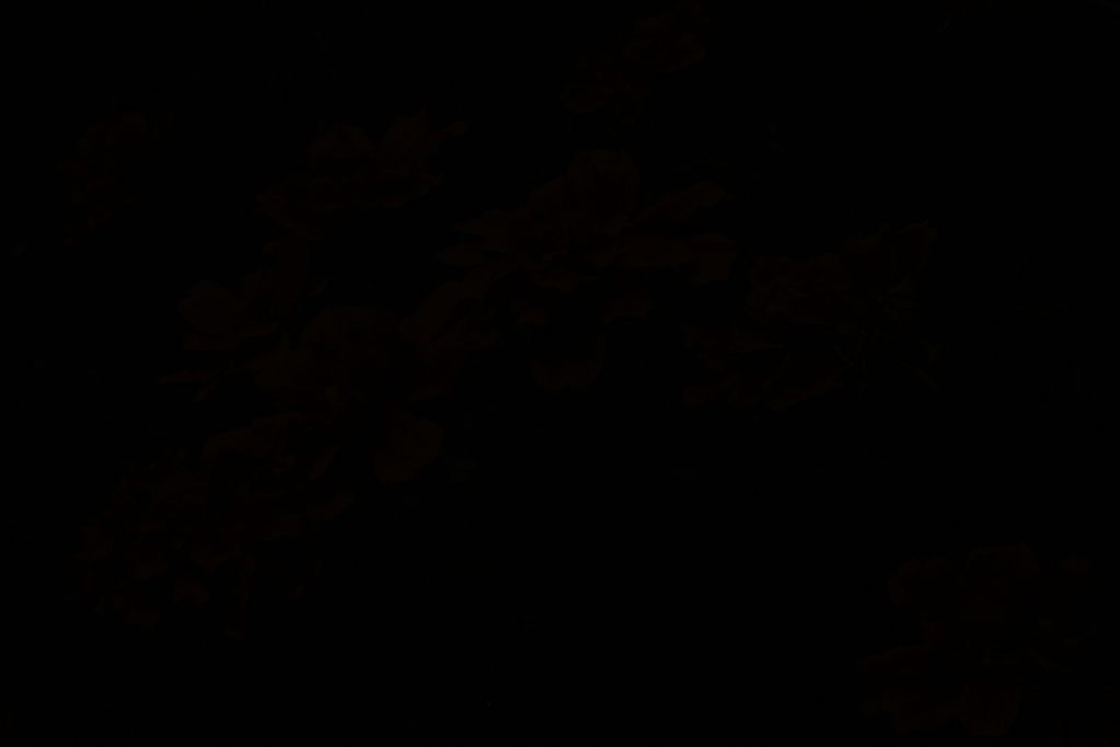

Jun 26, 2012 16:32 |  #5
IMAGE: http://i127.photobucket.com/albums/p122/BrokenChainsX/Testf16iso100shutter1600.png
This one is with the ISO at 100, F/16 and Shutter 1/1600th
IMAGE: http://i127.photobucket.com/albums/p122/BrokenChainsX/Testf16iso100shutter100.png
And this one is with the ISO at 100, F/16 and Shutter 1/100th

Your pictures don't have exif intact. Is this what you had the camera set to or what the actual exif data showed?

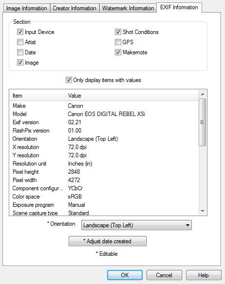

EsotericForest
14 posts
Jun 26, 2012 17:18 |  #8

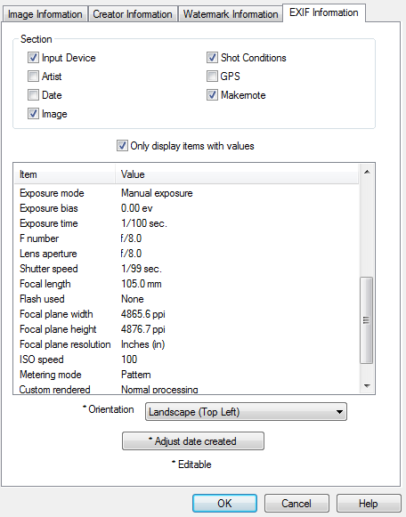

IMAGE: http://i127.photobucket.com/albums/p122/BrokenChainsX/ExifInfo.png
The camera is in manual so what is written under the photos is what I set it to, but here is what the data says.

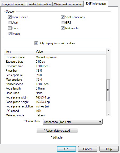

EsotericForest
14 posts
Jun 26, 2012 17:23 |  #9
This one is of the first image with the shutter at 1600.
IMAGE: http://i127.photobucket.com/albums/p122/BrokenChainsX/exifinfo2shutter1600.png
ohata0
561 posts
Likes: 12
Jun 26, 2012 17:29 |  #10
what are you using to view the exif data? Do you have DPP installed? The exif shouldn't look like that normally.
Also, what lens are you using with your camera? When I use old manual focus lenses on my camera, it doesn't show the aperture correctly because I don't have a chip on my adapter, but the exposure time and is fine.

crn3371
7,198 posts
Location: SoCal, USA
Jun 26, 2012 18:40 |  #11
That's some pretty strange exif.

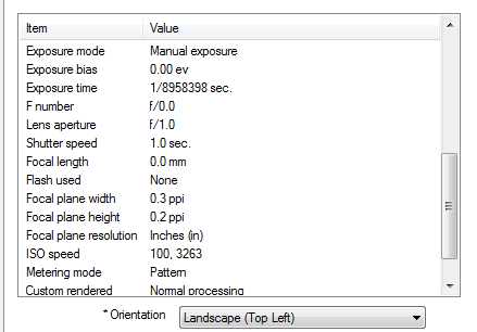

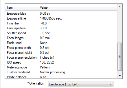

Jun 26, 2012 18:52 |  #12
Yes, strange EXIF data. "Exposure time 1/8958558, shutter speed 1.0 sec. and f1.0." - what is difference between exposure time and shutter speed? About a million to one apart as 1/8958558 is essentially one millionth of a second and obviously shutter speed is stated as 1.0 sec.
By the way what lens is being used, and is it seated properly into the bayonet mount?
EsotericForest
14 posts
Jun 26, 2012 20:27 |  #13
Data in the Bridge?
I used Corel Paint Shop Pro X4 to view the EXIF, in the Image Information section.
As for what lens it was shot with, it is a Canon Ultrasonic 28-105mm.

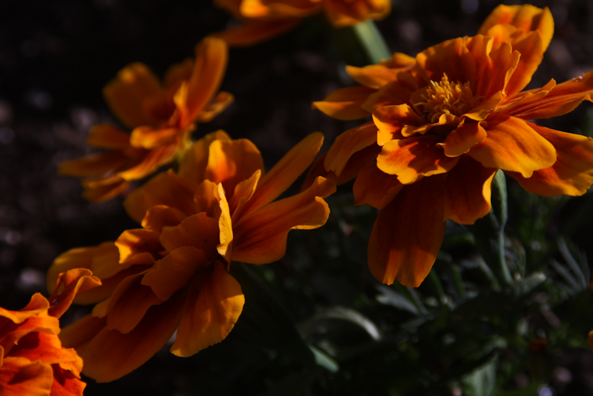

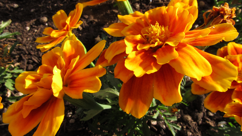

Alright so here maybe is a better example. The first photo is taken with my SLR, Canon Rebel XSI 450D
IMAGE: http://i127.photobucket.com/albums/p122/BrokenChainsX/SLRTest.png
IMAGE: http://i127.photobucket.com/albums/p122/BrokenChainsX/EXIFSLRTEST.png
IMAGE: http://i127.photobucket.com/albums/p122/BrokenChainsX/EXIFSLRTEST2.png
The second photo was taken with the same settings with my wife's Canon Power Shot SX130 IS
IMAGE: http://i127.photobucket.com/albums/p122/BrokenChainsX/POINTSHOOT.png
IMAGE: http://i127.photobucket.com/albums/p122/BrokenChainsX/EXIFPOINTSHOOT.png
IMAGE: http://i127.photobucket.com/albums/p122/BrokenChainsX/EXIFPOINTSHOOT2.png
