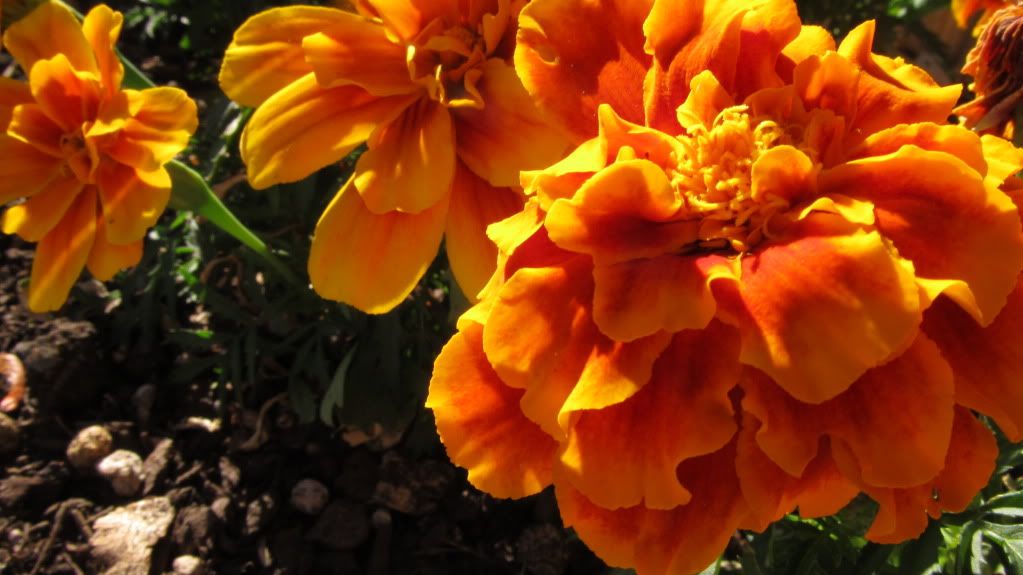

kjonnnn wrote in post #14636651 (external link)
The data in Bridge says..
Created 6-25, 9:41pm
15.0s at f1.4 +5 ISO 100
Focal length 505mm
BOTTOM PHOTO
Created 6-25-2012, 9:43pm
15.0s at f1/4 +5 ISO100
Focal length 455mm
Go Figure.....
Where does one buy a lens that goes into 455mm-505mm range, especially one which is capable of f/1.4 ?! :eek:
Diagnosis: Sick camera. Send to Canon for emergency surgery.

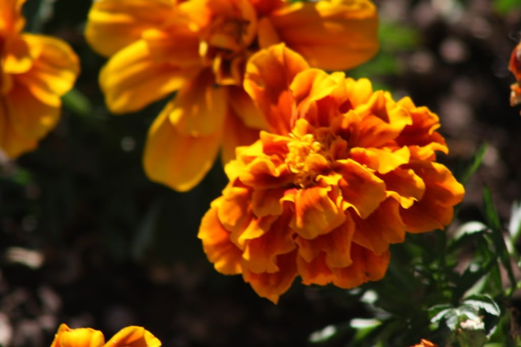

Jun 27, 2012 20:51 as a reply to  @ Bill Boehme's post |  #38

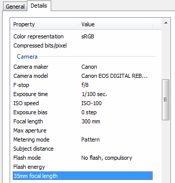

Alright, looks like it may be lens related. Hopefully the EXIF is still intact with these. I uploaded them to photobucket, straight from the card. Yes they were shot in Manual, so I could be sure it would have the same settings in each photo. The goal wasn't to get perfect exposure, the goal was to rule out variables for a test. Sorry the first one is blurry, that's what I get for just free holding with a 300mm lens haha.
Canon 450D with 300mm lens
http://i127.photobucke​t.com …rokenChainsX/IM​G_1668.jpg (external link)

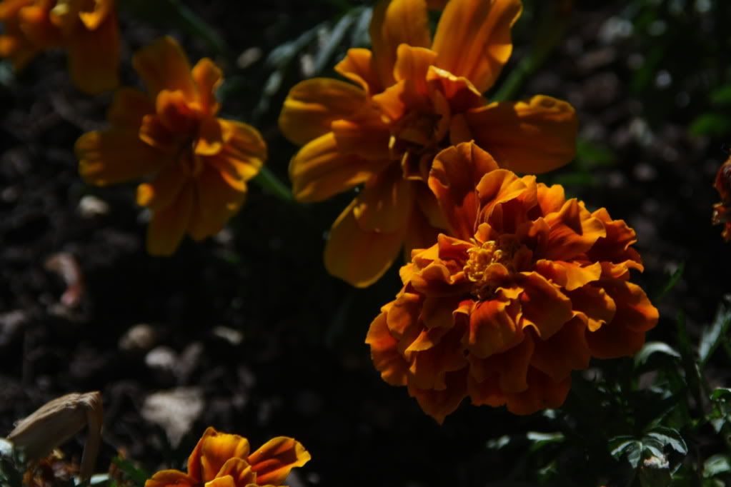

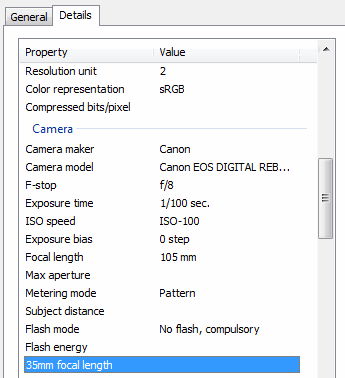

Canon 450D with 105mm lens
http://i127.photobucke​t.com …rokenChainsX/IM​G_1669.jpg (external link)

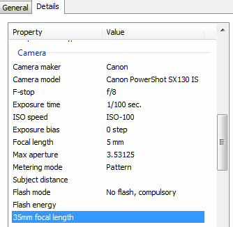

Canon Power Shot SX130 IS
http://i127.photobucke​t.com …rokenChainsX/IM​G_2461.jpg (external link)

OK, 105mm underexposed at 1/100 f/8 on your camera, yet 300mm was fine at same 1/100 f/8 exposure on your camera. And your wife's camera exposed just fine at 1/100 f/8, too.
Therefore, I blame the 105mm lens, since your camera performed fine with the 300mm lens and your wife's camera was fine with same indicated exposure.
