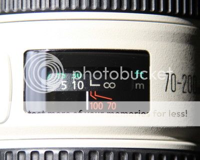

I was being a little tongue in cheek, but if you use the focus scale and match the appropriate FL line with the vertical part of the elongated "L", that's infinity focus - it works on all my lenses.
Thus...
IMAGE: http://i985.photobucket.com/albums/ae334/SJBarra/Focusscale.jpg

No, I get that - but on my 24-70, when I tried it, it didn't work. Honest. I didn't throw the focus ring as far as it'd go, just lined it up with the infinity marker, and took a test shot, and it was blurry.
I also tried hyperfocal focusing (somewhat familiar with the concept since I got my manual 14mm lens :p), which I guessed was between 5-10 metres (no calculator with me). I placed the ring at 10m, took a test shot - blurry. That's the point where I went "oh screw this " and ended up taking a few shots, turning the focus ring a little bit every time, and found the sweet spot through trial and error (although having the presence of mind of using live view would have saved a lot of trouble).
I guess my distance scale must be off.
