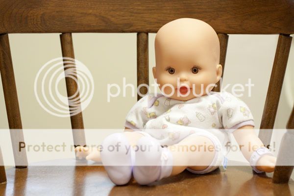

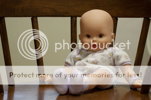

Jul 15, 2012 18:21 as a reply to  @ davidc502's post |  #13
tiaanb wrote in post #14720846 (external link)
Does this help at all?
Yes. The graph should be shifted more to the right, i.e., more exposure.
The camera's ambient meter and flash meter are only guidelines.
My doll as metered by the camera:
IMAGE: http://i735.photobucket.com/albums/ww357/oldvultureface/POTN/IMG_1513.jpg
As metered by me:
IMAGE: http://i735.photobucket.com/albums/ww357/oldvultureface/POTN/IMG_1515.jpg
200% crops to show the difference in noise levels. No noise reduction applied to RAW's:
