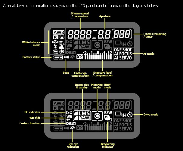

You may have a bad camera, but I also think it is just your battery. It's much cheaper to buy a spare battery rather than sending in your camera for an estimate. You should try another battery even if you have to borrow one.
Where are you located? Sterlingtek ships to Canada as well. If you are in the U.K., Amazon has cheap batteries that should work well: http://www.amazon.co.u​k …8%2Ck%3Abp-511&sort=price (external link)
This review has a lot of pictorial detail into the features of your camera and can help you learn the various functions. http://www.dpreview.co​m/reviews/canoneos30d/ (external link)
IMAGE: http://i2.photobucket.com/albums/y17/msowsun/photo%20stuff/Photo9/001aaa-1.jpg
