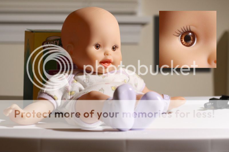

580 on camera aimed at Pat, 430 high and camera right. Both firing (A+B+C):
IMAGE: http://i735.photobucket.com/albums/ww357/oldvultureface/POTN/IMG_1710.jpg

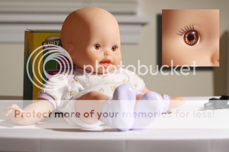

580 disabled, head aimed at Pat:
IMAGE: http://i735.photobucket.com/albums/ww357/oldvultureface/POTN/IMG_1706.jpg

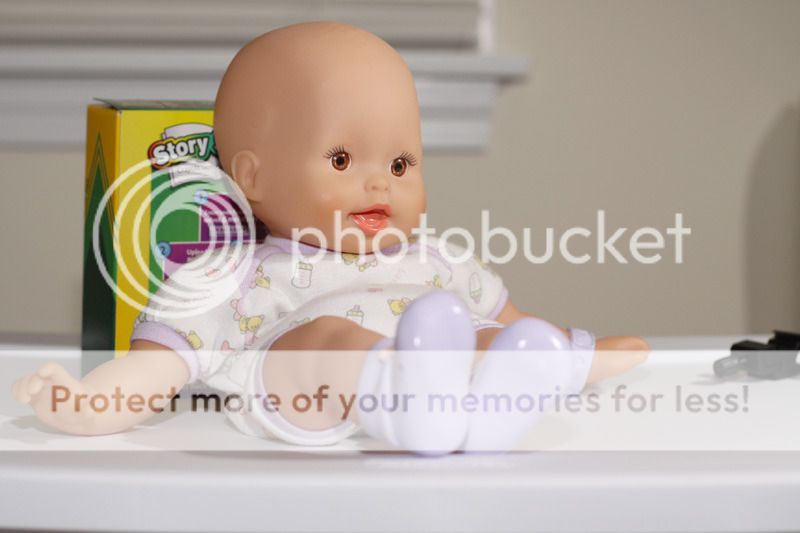

580 disabled, head aimed 90° right:
IMAGE: http://i735.photobucket.com/albums/ww357/oldvultureface/POTN/IMG_1708.jpg
Admittedly, being 2½ feet from the subject at f/4 makes the trigger flash from the disabled master more obvious than shooting at 15 feet and f/8.
