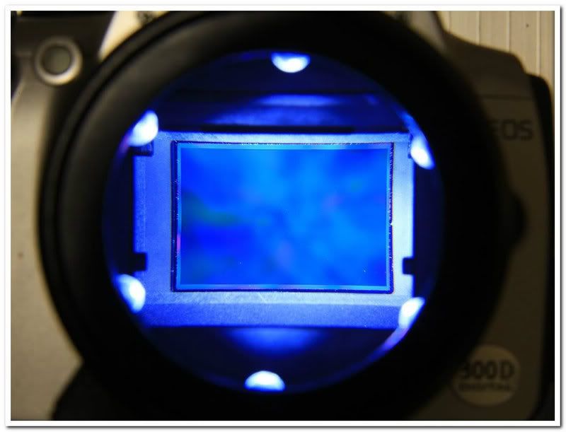

There is a mis-conception that you can remove the focusing screen on the 7D, because its a transmissive lcd screen you cannot remove it, so don't even try.
Since you can't remove it be very careful using any form of blower or can air directly on the screen, as this may push the the dust particles further into the pentaprism block and behind the transmissive lcd screen. In this situation only Canon would then be able to remove them.
I have been able to remove dust on the focusing screen by using my Electric butterfly staticly charged brush which attracts the dust to itself, allowing you to remove it from the camera rather than blowing it around inside. There is a right angled mirror brush head to make it easier to reach the focusing screen, the trick is to use the static charge to attract the particles by lightly touching the spots rather than brushing the whole surface.
IMAGE: http://i81.photobucket.com/albums/j226/lannes2007/IMG_9389-1.jpg

lannes wrote in post #14777348 (external link)
I think you need some sort of illuminated loupe to see the sensor spots, their not that visible without magnification.
THIS! really helps :)
