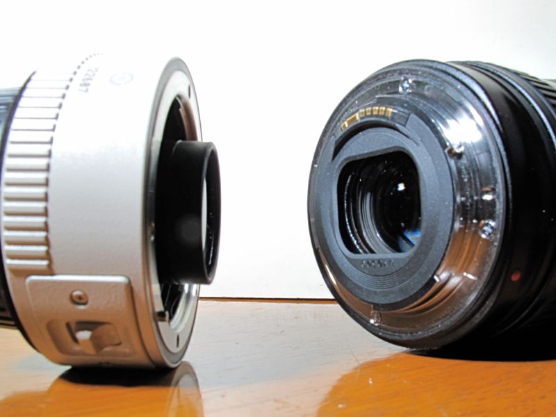

Jul 27, 2012 08:18 as a reply to  @ sega62's post |  #8
Canon Extenders can not physically be attached to the 24-105. The front element of the extender protudes into the rear of the lens it is mounted on. The 24-105 does not have an opening at the rear of the lens to allow for this.
Canon Extenders report the resulting f-stop to the body, so a 2x extender on a f/4 lens will result in a reported f/8, Canon bodies(other than 1 series) lose AF at f/8.

Jul 27, 2012 11:45 |  #9
^^ Yup.
IMAGE: http://i17.photobucket.com/albums/b86/hectormac/G10_270EX/IMG_0018.jpg

Jul 28, 2012 16:25 |  #11
xhack wrote in post #14777810 (external link)
^^ Yup.
Is this an example of attempting to put a round peg in a(n almost) square hole ? ROFL when I saw this.. :lol:
