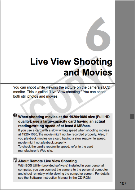

I mounted a number of flash units, including a 550 a 220 and an ST-E2 to the camera and the menus stayed the same. None of these are EXII units and that may make the difference. With these mounted, or with no flash, I do not see a menu item past Flash Firing (Enable or Disable) and no amount of scrolling will go any further.
The 5D2 manual stops its discussion of flash systems at page 106. There appears to be nothing in the 5D2 manual about Wireless Set. I have attached a copy of page 107 for you to see this.
I now understand that I can use the 550's and set up FEC manually on each flash. What am still unclear about is will the 5D2 reveal new menus items if a EXII flash is installed on the camera? Will the Wireless Set screen then appear?

Sep 04, 2012 07:59 |  #291
jmaher wrote in post #14945586 (external link)
What am still unclear about is will the 5D2 reveal new menus items if a EXII flash is installed on the camera? Will the Wireless Set screen then appear?Jim
Yes.
With the 40D and another model, and the 580EXII and 430EXII Speedlites, Canon introduced camera menus that could control flashes that were built to be controlled. The camera can recognise these capabilities, and display menus appropriately.
Previously, the 550EX could be controlled to some extent using the camera buttons, and now, matching menu items will be enabled, and the flash controlled from the camera - in ETTL/FEC mode, etc. (50D/550EX enables menus flash exp. comp. and E-TTL II mode selection.) Prior to the menus, turning on ratios on the 550EX as Master meant stepping through arcane cycling displays. With the 622, the camera menus are enabled (and verbose) and the transmitter acts as the Master.
