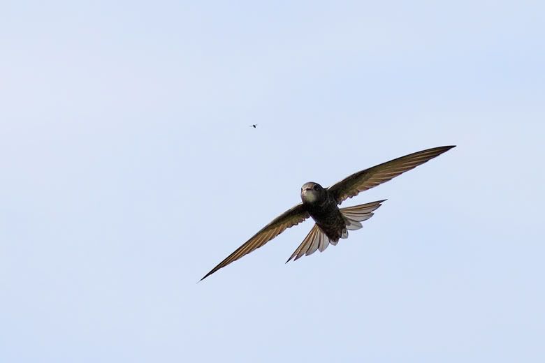

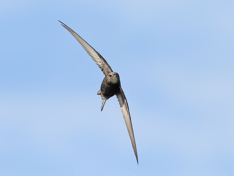

single point expansion is great for shooting small BIF's ;)
IMAGE: http://img.photobucket.com/albums/v111/joe47/IMG_9578b780.jpg
IMAGE: http://img.photobucket.com/albums/v111/joe47/IMG_9986b780.jpg
IMAGE: http://img.photobucket.com/albums/v111/joe47/IMG_9942b780.jpg

Still trying to shoot swallows here as well with my 100-400 and 1DMk2, with very little success. Nice shots Joe52
Just wondering what I could adjust to get more shots infocus, can or should I adjust AF sensitivity as well ?
Bruce
Joe52
3,131 posts
Gallery: 151 photos
Likes: 1083
Location: Dorset, UK
Aug 03, 2012 09:21 |  #12
Bsmooth wrote in post #14808830 (external link)
I have the AI Servo Tracking Sensitivity set to the slowest, on my 7D, I also use back button focus.
