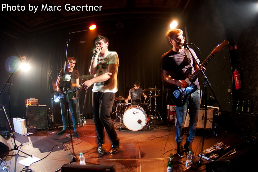

For this image I used three external flashes. Two at the front of the stage pointing to the middle of the stage and a third behind the stage left pointing to the drummer/center of stage. Some color gels on them (blue, red). This photo was shot with a slow shutter to fill in some ambient too:
You can see the one behind the band in this photo and guess the one on the right.
IMAGE: http://photo.marc-gaertner.de/zenphoto/albums/2012/05-19-keinkultur/IMG_7092.jpg

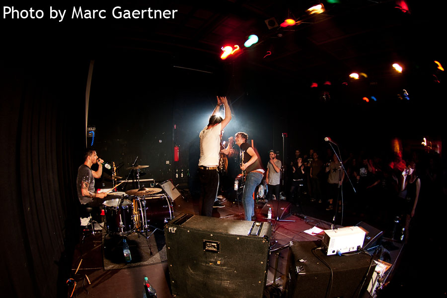

Shot from under the flash that is visible in the photo above:
IMAGE: http://photo.marc-gaertner.de/zenphoto/albums/2012/05-19-keinkultur/IMG_7099.jpg

Nice :)
