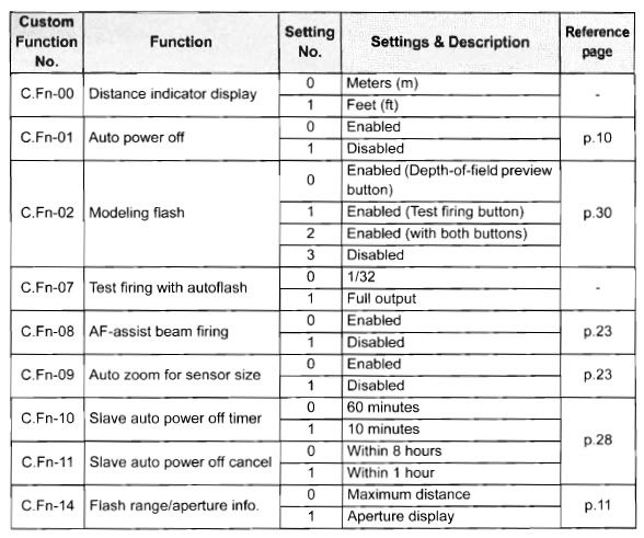

Since you have a T4i I would suggest getting the 430EX II because it supports the in-camera flash menu. (the older 430EX is not compatible with the in-camera flash menu)

If that isn't enough, here are a few more reasons:
1) Metal Hotshoe
2) Quick release mechanism
3) Silent recycle
4) Faster recycle
5) Nine Custom Functions (vs 6 on 430EX)
IMAGE: http://i2.photobucket.com/albums/y17/msowsun/photo%20stuff/430EXIICustomFunctions.jpg
