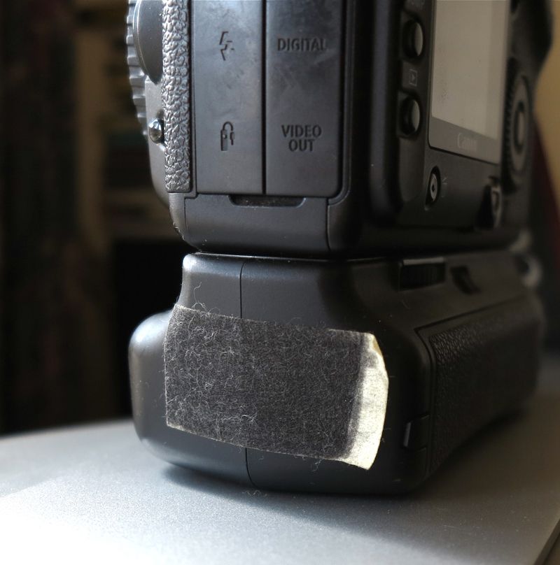

I've not lost a rubber blanking piece . . . yet. But it's too fiddly, so I black-markered some surgical tape which is stuck to the grip for instant access. I've only used it three times in 18 months, so probably not worth the effort.
