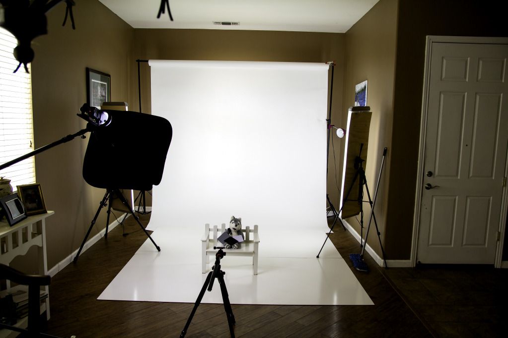

Lost my job couple of weeks ago - ((enjoying some me time as the wife and I have some funds for just such a rainy day))
Decided to convert the living room into an inexpensive temp studio while I clean out the garage. Once I get rid of our boat I will move the studio into the 3rd car slot that the boat currently occupies.
IMAGE: http://i1103.photobucket.com/albums/g463/Roc34ky/Home%20Studio/Living_Room_Studio.jpg
Let me know your thoughts - Backlights are from Home Depot; 4-bulb T8 florescent with ¼” plywood backing that I attached my spare camera stands too via the ¼ -20 quick-connect bolt.
Floor is white tile board sitting on a continuous roll of paper that is held by an 8’-6” square perfect stand, and a single YN-565 EX fired wirelessly via a pair of YN-603C’s through a 24” Q-box.
Home Depot - $78.50 ea for the florescent lights
$36.00 for a box of 10 T-8 bulbs
$13.00 ea for the tile board
Amazon - $75.00 SP2000 Backdrop Background Support Stand
$64.00 - Savage Seamless Background Paper, 107" wide x 12 yards, Super White, #1
Give or take $360.00 plus the flash, Q-box and accessories that I already had; here is my first attempt.

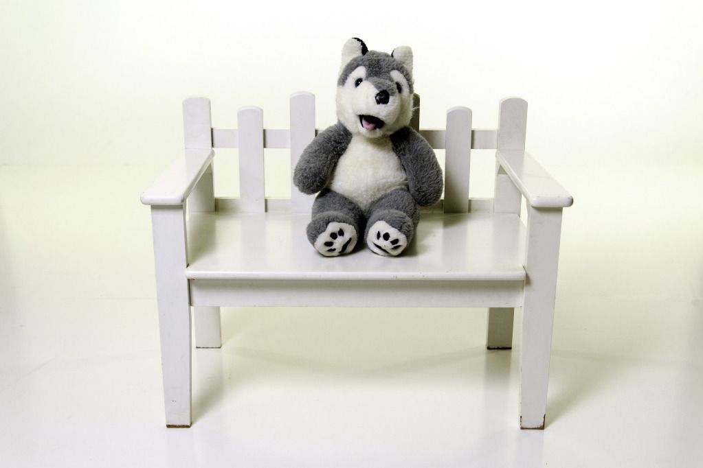

IMAGE: http://i1103.photobucket.com/albums/g463/Roc34ky/Home%20Studio/Grey_Card_Wolf.jpg

Sep 06, 2012 17:29 |  #2
Nice result.
I'm surprised the florescent bulbs were enough to get the background white. It also appears that the whitebalance between the florescent and strobe isn't too bad.
Only thing you'll have to work on is controlling all the shadows. I notice under the white bench that there are shadows from the florescent light sources, the strobe and then the reflections coming forward on the tile board. That's quite busy. May be a little less of a problem with a person but still something to take into consideration.
And, if the white for the background is the result of slow shutter you will have to take car when shooting people or other actives subjects.

Sep 06, 2012 17:37 |  #3
there's a LOT of falloff from the BG lights though. Not white edge to edge. A tasteful crop will help final images

Sep 06, 2012 18:26 |  #4
Nice setup. I agree keep working the lights for balance, reflection and shadow control. Great start.

Sep 06, 2012 19:31 |  #5
you may want to try a tripod and drag the shutter a bit, if you can, for the BG.

Sep 06, 2012 22:22 |  #6
hawk911 wrote in post #14957152 (external link)
Dragging the shutter is a reasonable approach with static subjects but can become problematic if the subjects are active.
As I've revised the thread I also notice a distinct yellow cast from the background that is also on parts of the bench that are reflecting the background as a light source.
That suggests that it is probably a good idea to come up with a warming gel for the speedlite to get it closer to the background light color temp. Not much maybe a 1/8 CTO or CTS.

Sep 07, 2012 06:07 |  #8
dmward wrote in post #14957842 (external link)
it might depend on how much ambient light is left after the flash went off, but yes... dragging the shutter does leave you open to movement.
