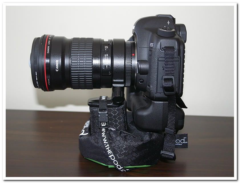

I like "the pod", as it actually attaches to the bottom of the camera or the tripod ring so there is no set up time.
The block support can be separated from the main pod, and is only used when you might have a battery grip on, the rest of the time just use the pod by itself
IMAGE: http://i81.photobucket.com/albums/j226/lannes2007/IMG_9315.jpg
http://www.thepod.ca/ (external link)
