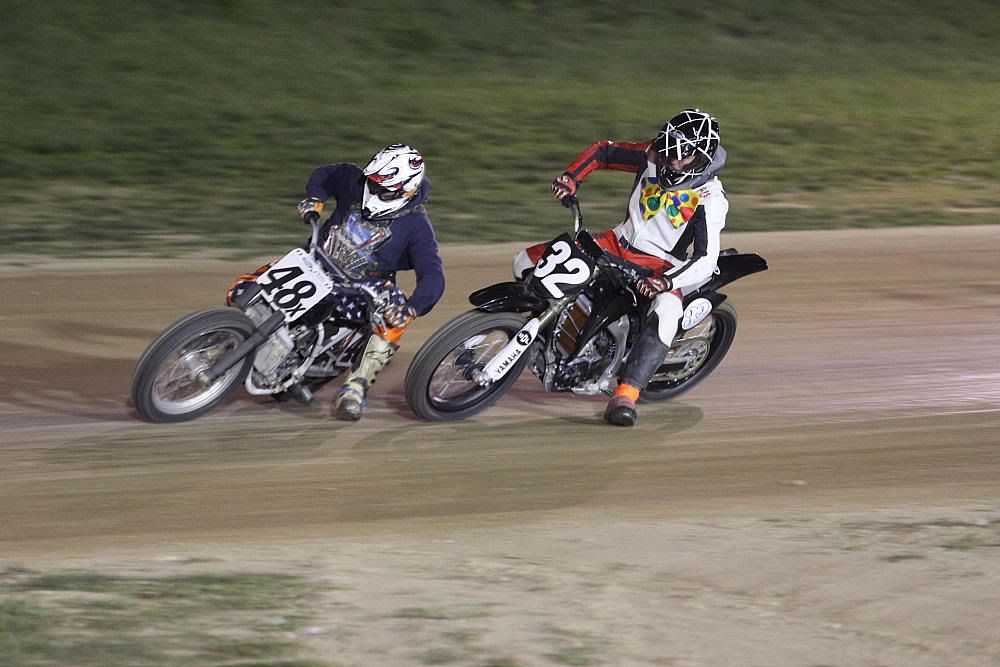

Sep 24, 2012 10:40 |  #2
V4her wrote in post #15035421 (external link)
I have a first opportunity at the end of October for some night racing at VIR. I didn't know what techniques photographers typically used for successful night racing shots.
Fast lens and high ISO. There are no mysteries and no miracles. In these examples, a 60D and a Sigma 70-200mm f/2.8 lens were used. Any comparable equipment will give similar results.
IMAGE: http://i1174.photobucket.com/albums/r601/kevinlillard/20111029c0011_zpsc40e6e49.jpg
Focal Length: 70.0mm
Aperture: f/2.8
Exposure Time: 0.010 s (1/100)
ISO equiv: 1000
Exposure Bias: none
Metering Mode: Matrix
Exposure: program (Auto)
White Balance: Auto
Flash Fired: No (enforced)
Orientation: Normal
Color Space: sRGB
IMAGE: http://i1174.photobucket.com/albums/r601/kevinlillard/20111029c0038_zps1014eb7f.jpg
Focal Length: 91.0mm
Aperture: f/2.8
Exposure Time: 0.0063 s (1/160)
ISO equiv: 2500
Exposure Bias: none
White Balance: Auto
Orientation: Normal
Color Space: sRGB
IMAGE: http://i1174.photobucket.com/albums/r601/kevinlillard/20111029c0046_zps01f28764.jpg
Focal Length: 200.0mm
Aperture: f/2.8
Exposure Time: 0.0025 s (1/400)
ISO equiv: 3200
Exposure Bias: none
Exposure: Manual
Exposure Mode: Manual
White Balance: Auto
Orientation: Normal
Color Space: sRGB
