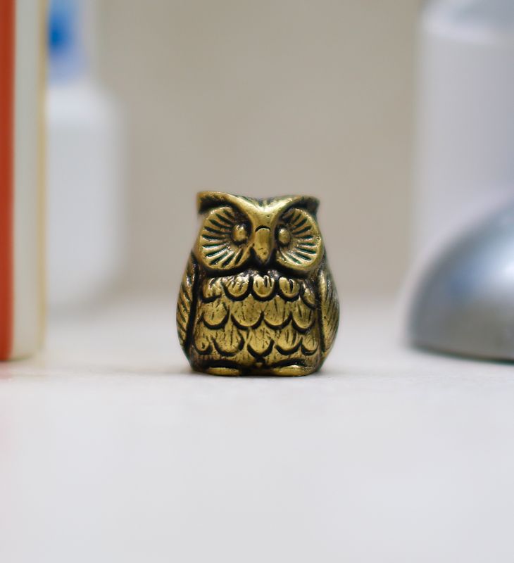

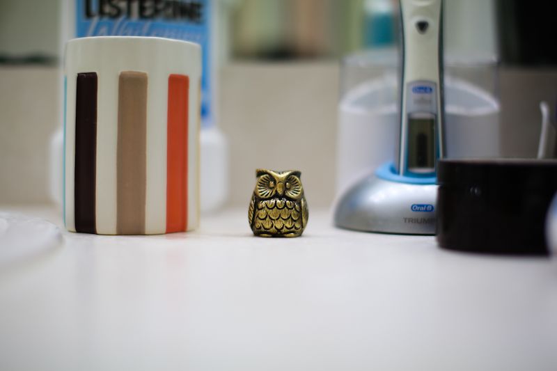

Sep 25, 2012 23:19 |  #59
JLai81 wrote in post #15039649 (external link)
So you're saying the top picture is soft @ the whiskers? Top picture looks ok to me.
I guarantee you zoom in any picture close enough and it's going to look "soft"...especially when I zoomed in on something as small as a whisker. I simply magnified the crop to show were I focused.
I'll go retry with a stationary object tonight.
Try this one. To put this in perspective of the 100% crop image, the actual statue is only 1 inch tall.
IMAGE: http://i187.photobucket.com/albums/x138/jlai81/Sigma%2050mm/IMG_3476-2_zps4e94a758.jpg
100% crop image
IMAGE: http://i187.photobucket.com/albums/x138/jlai81/Sigma%2050mm/IMG_3476_zps94fe36f7.jpg
