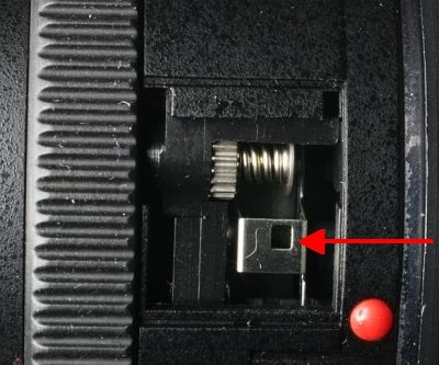

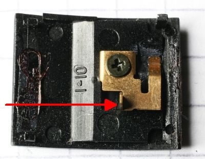

When you popped in the M/AF switch, it is possible that you didn't get it in the right position to engage the little pin that operates the focus mechanism. You could try popping it out yourself and making sure you put it back together so the pin is correctly aligned. Or, it would be a simple fix at a repair shop.

IMAGE: http://i2.photobucket.com/albums/y17/msowsun/photo%20stuff/Photo9/_1aaa.jpg
IMAGE: http://i2.photobucket.com/albums/y17/msowsun/photo%20stuff/Photo9/_1bbb.jpg

Thanks for the illustration Mike. Because of it, I found that the copper tab on mine were bent therefore not making any contact when I switch from MF/AF. As soon as I bent it to the appropriate angle, AF is now working.
