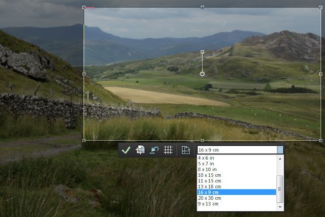

I've been wondering if this is possible for some time - I worked it out last night.
My PC screen is set to display in 16:9 format, therefore I crop a lot of my images to either 3:2 for printing or 16:9 for desktop display. By default there is no 16:9 option in the Crop Tool.
Here's how to add 16:9 as an option:
In Windows Explorer, navigate to:
...Program Files (x86) > Corel > Corel PaintShop Pro X4 > Languages > EN > Presets > Metric
(Your navigation path might be a little different due to country and installation preferences, but you should get the gist)
There will be a number of * PspScript files - open one in Windows' Notepad, it might look something like this:
from PSPApp import *
def ScriptProperties():
return {
'Author': u'Corel Corporation',
'Copyright': u'Copyright (c) 2003-2004 Corel Corporation All rights reserved.',
'Description': '',
'Host': 'Paint Shop Pro',
'Host Version': '8.00'
def Preset_Crop():
return {
'CropRect': ((0,0),2125,1535),
'Mode': App.Constants.CropMode​.CustomPrint,
'Units': App.Constants.CropUnit​s.Centimeters,
'PrintWidth': 18,
'PrintHeight': 13
def Do(Environment):
App.Do( Environment, 'Crop', Preset_Crop())
Amend the "cropRect" line to read: 'CropRect': ((0,0),1600,900),
Amend the Printwidth line to read: 'PrintWidth': 16
Amend the PrintHeight line to read: 'PrintHeight': 9
Then, from Notepad, File > Save As and give it a pertinent filename, perhaps; Preset_Crop_16 x 9 cm.PspScript
Start Corel PaintShop Pro X4 and the new crop preset should now be available in the drop-down list.
IMAGE: http://i243.photobucket.com/albums/ff140/Trugga_bucket/Miscellaneous/crop169.jpg

My first thought was "why not just crop it in free form and save it as a new ratio from the drop down menu?"
Now I see why: for some reason that option no longer exists. Can't save new ratios to the drop down list in X4 or X3.
I had several custom ratios that I'd saved in an earlier version, probably PSP X or X2 - for some reason Corel has eliminated the option.
Irritating!
Thanks for the tip - guess I'll be doing it your way in the future...

I'll admit my solution is not based on a full understanding of the script system, although I do have a little coding knowledge.
The 'CropRect': ((0,0),1600,900), defines a rectangle, from 0.0 (bottom left) to 1600,900 (top right).
I used a similar size (number) to the samle I chose to make a copy from.
I'm not sure what the print width & height are, but it seemed, prudent to change them.
The file name; Preset_Crop_16 x 9 cm.PspScript appears to gemerate the list item entry (after the _).
It all seems to work (for me at least).

I don't know why we are bothering with this when PSP X4 will do it for you:
1. Open crop tool
2. Select Free Form
3. Adjust width and Height in boxes on toolbar
4. Select maintain aspect ratio
5. click on Presets on toolbar
6. click on disk icon, name your new preset and save it
Just out of interest take a look at the new script file you've just produced.
It's at MyDocuments/CorelPaint​shopPro/14.0/Presets
Now try to understand the CropRect and print size figures !
