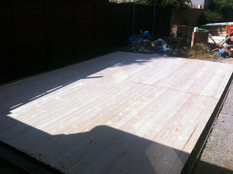

The concrete base (6") went down, and the tongue and groove base has gone on top. It has been damp proofed and is raised for ventilation.

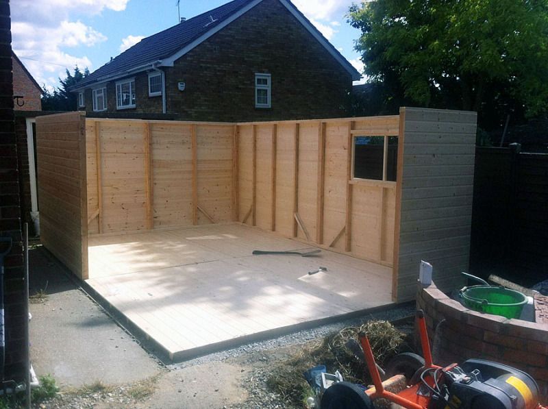

The walls starting to go up. The dimensions are 12ft wide x 18ft long.

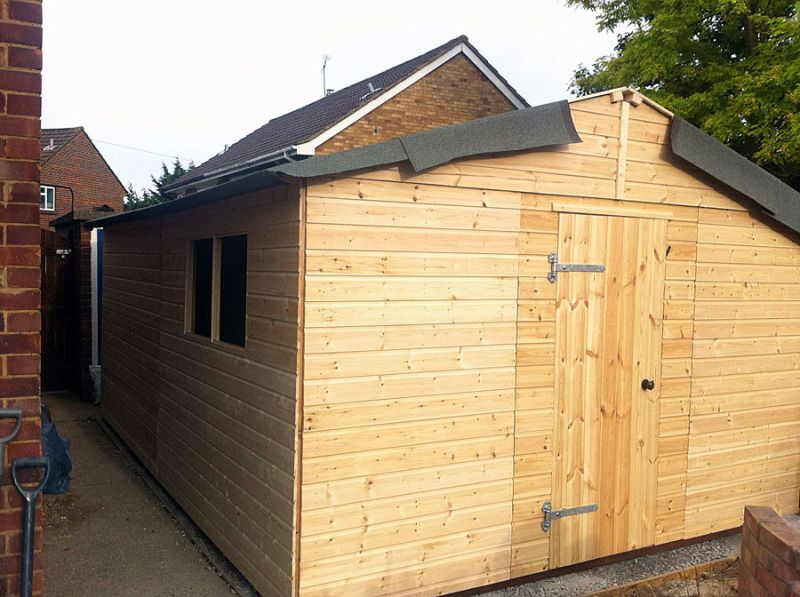

The front is now on, and roofing ready to follow. There are only windows at the door end, as i want total control over light at the other end.
IMAGE: http://i91.photobucket.com/albums/k287/dinof/studio3-1.jpg
The roof is now on, its tongue and groove, very strong. The roofing felt is the thickest i can buy, heavy too.

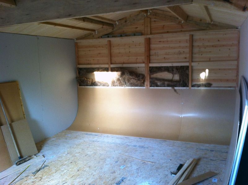

The walls have been insulated, and have been plasterboarded, here you see the beginings of the infinity curve.

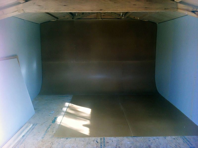

Infinity curve almost finished. The floor for the curve is being layed down ready for fixing. Everything will then be filled and painted.

What support is there under that curve? I want to install a curve in my studio (I rent a 7m x 6m room). I can put the timbers on the wall to affix the boards to, but just wondered about support in the curve. And is it hardboard you are using for the curve, walls and floor?

The curve is made up from 22mm ply, with the radius cut out, placed at 2ft apart and then 2"x2" batons screwed into them joining them up and together creating a curved ladder. Although its only covered with hardboard, its pretty strong.
