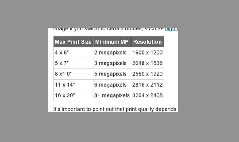

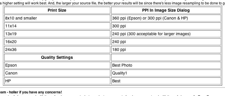

People typically print 8 by 10 so I usually set it for 3000 on the long side (to keep the file size small), select the paper type and standard. Sure you have more control in PS for output sharpening but in the long run how many complaints do you get using LR for that?

As for size I export Jpegs for print @ 3000 on the long side but I am across a thread yesterday. Nicksan and a few others were in it and some numbers were coming in at 3600 and 3888. I had been wondering if I should increase my files just incase. I can't find that thread.
