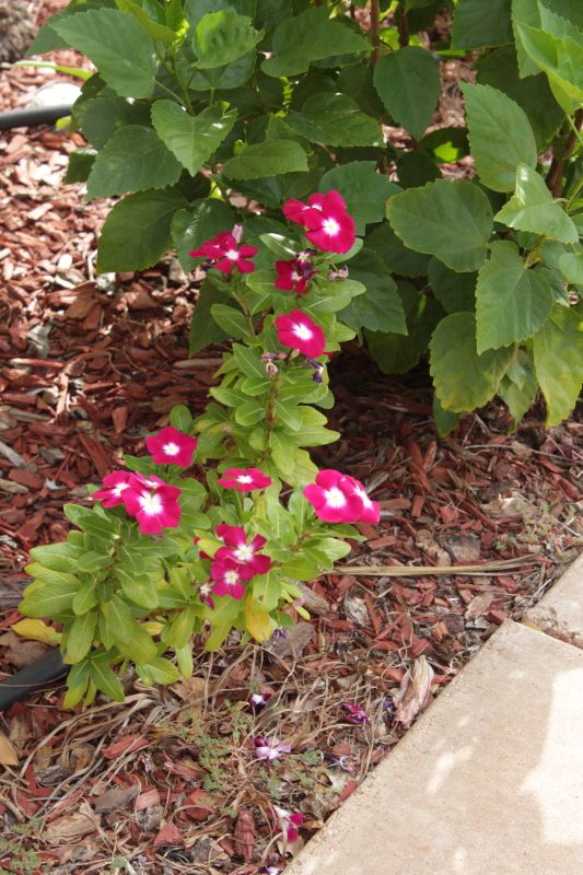

Yes, I know how to select the AF Point but right now when I half press the shutter button ONLY the Center Point is focusing. I need all 9 to focus. This is how my photos come out now:
IMAGE: http://i1058.photobucket.com/albums/t403/gilbean53/IMG_6328.jpg
IMAGE: http://i1058.photobucket.com/albums/t403/gilbean53/IMG_6322.jpg
They are sooo OOF it is not funny.

You need to clarify a bit more what your problem is. The sample shots don't help on their own.
It sounds like you no longer want manual AF point selection, so turn it off and let the camera figure out where to focus. Note that the center point is the only cross-type AF point, so it will perform better than the others on low-contrast subjects.

WatterRockets, my Main problem is I cannot seem to get a focus on ANY photo I take. Since I have it set to Center Point AF, I thought switching to 9-Point AF would help but all of you say Center Point is best for focus. I posted the photos so you could see my focus problem. I will give you the EXIF for each photo. Will that help clarify my focus problem?

That is probably TMI but I cannot seem to focus correctly regardless of the subject.
Thank you for you help. And if this does not tell you what you need to help me cure the dismal focus, please tell me what info you need. Thanks again.

Hmm. In the flower shot, at f/8, I don't see a focus problem, and the depth of field is huge, so it will be hard to see.
In the SUV shot, it looks to me like the center of the frame (front of truck) is in focus. I'm seeing some compression artifacts in the Ford emblem, but no focus issues at the resolution you've posted.
Can you show us a shot of something close (a few feet away), high contrast, shot with aperture f/3.5 with the zoom all the way back at 18mm? That will help a bit more than the shots you posted.
Also, have a read of this thread and post back in here with any related questions or ideas. https://photography-on-the.net/forum/showthre​ad.php?t=857871

Just looked at the images on my phone and I don't think they so OOF like you say. Is this one of then cases where

I may have found my problem. In DPP, I am viewing the RAW images AS SHOT: NEUTRAL. They are OOF and at 100% they are blurry.
Picture Style Neutral
Sharpness 0
Contrast 0
Saturation 0
Color tone 0
When I changed SHOT SETTINGS = Daylight and PICTURE STYLE = Standard or Landscape everything turned SHARP and CLEAR.
Gentlemen, if this is my OOF problem I feel about 1/4 of an inch tall, DUMB and a ROYAL A$$ for wasting your time. IF this has been my ONLY focus problem:
I Sincerely apologize for wasting your time. Will you please forgive me for wasting your time and effort?
